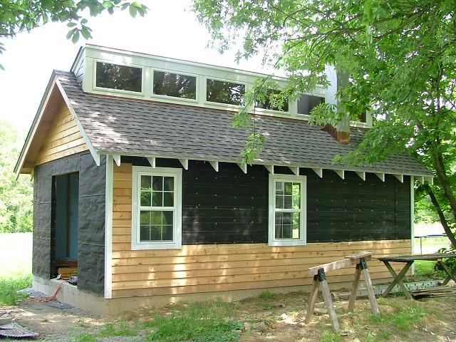

Hi all,
I’m building a 16 x 24 workshop (for my wife) with a 13′ (at the ridge) cathedral ceiling. Walls are 2 x 4 construction with fiberglass batts, and roof is 2×8 also with FG batts.
I am interested in heating it with a propane fired infrared heater suspended overhead. (I already have a 500 gallon propane tank for home heat and the gas company says I need to use more to help them out, so I would just add another line to it). How many btu’s should I be considering? The shop doesn’t need to be super warm. Fifty degrees would be adequate. We live in the greater Cincinnati area where winter temps don’t usually go too far below the teens.

    I have a 20ft square garage in the Detroit metro area, and a 20 to 30k btu kerosene heater that theoretically should be adequate. It isn't.
    The heater will easily keep the garage at a comfortable temperature, but it takes forever to get it there. Unless the workshop will be continiously heated, I'd look at something significantly larger than 30k.
    Oh, and fifty degrees isn't too cold. Fifty degrees, when everything you touch is 19 degrees, is absolutely freezing.

    If you had the heat well distributed, 30,000 should cover the shop, more or less. If the shop is used intermittantly, like most home shops are, consider a little more for quicker heat up when you need it. Detroit Radiant, under the trade name of Re-Verber-Ray, makes an excellent residential product in the form of a low temp infrared tube heater, that can be mounted with limited clearance.

    I've got a Reverberay heater in my shop, it's 25 X 50 with a 14 foot ceiling at the peak. It's a great, I mean really great, way to heat a space. My heater is 30 feet long.
    Be aware that it's hotter closer to the burner. The heat tapers off as it runs the length of the tube. I'd suggest you position the burner away from the main workspace if this is possible.
    I would strongly recommend the dual BTU one, the LS series, http://www.reverberray.com/products/ls.html Mine is 50,000 or 75,000 BTUs and rarely do I use the higher setting because it's uncomfortably warm. The 50,000 setting is very comfortable, I live in Montana. They have a 25,000/50,000 that would be great for you. I'd guess the 25,000 setting is where it would work best for you.
    I trashed the line voltage thermostat that came with the unit and replaced it with a household type mercury one. I also just put in a switch to flip it from 50,000 to 75,000 at the thermostat.
    It's a great heat, very comfortable, efficient and quick.

    Your heat loss with 65F inside and 30F outside, and R13 walls, R19 ceiling, 40 sqft of R2 windows, a slab floor with perimeter insulation, and one air change per hour infilatration is just over 15,000 BTU per hour. If you have big shop doors that are not well insulated or leaky that could go up quite a bit.
    If you have colder outside temps, the loss is linear with the difference between inside and out side, so going down to -5F would make the heat loss 30,000 BTU.
    As has been mentionded, some margin for starting up with a cold shop might be a good idea -- although, I'd think the radiant heating provided by this heater would produce at least some instant heat.
    Don't know if you have a big south facing rollup door or not, but this is the only heat I have in my shop -- on sunny days its good down to -20F -- great lighting.
