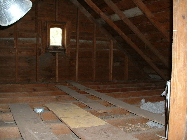

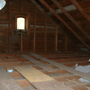

Recently moved into a 90+ year old house, in central KS, and found NO insulation in the small (16×14) attic directly over the master bedroom–though insulation was obviously blown into the walls of the house many years ago!?
I’ve purchased bags of cellulose but am not sure of exactly how, or if I need to, ventilate the attic.  It presently has no ventilation and no interior evidence of any moisture problems (maybe plenty of inadvertant ventilation?).  Do I need to put in soffit vents plus ridge vent–or maybe gable vent in place of current window? I have some of the styrofoam Durovents to put between the rafters, but am not sure how to get air INTO them, from the soffits (see pic).
And of course, the $64,000 question–what about a vapor barrier between the plaster and lath ceiling and the cellulose?
Many thanks.
Thon

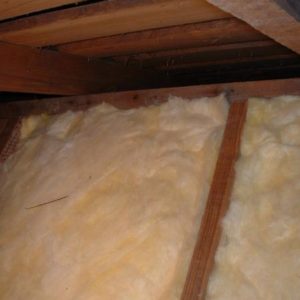

      Your attic looks just like mine (used to).
      This summer I had the lath & plaster of a bedroom upstairs in my 1931 house taken off, and even though I know Dad had insulation blown in in the '60s there was almost nothin there.
      So.....
      Besides the rewiring, I foamed in all the holes in the top plates where the knob & tube go down to their respective switchs and light boxes, insulate with rigid foam and seal the areas under the floor between the joists, and now I'm putting 3/8" plywood over where the K&T wiring runs.
      The entire area is being covered with R-40 (suitable for my area, but you will probably want R56) and then the drywall goes on.
      Since I'm doing a retro reno, I'm putting 6 mil vapour barrier in and, oh yea, adding 2x4 studs to the 2x3 there now, so that I can get R-28 into the stud cavity.
      Next year, the other bedroom upstairs.
      Taunton has a couple of good books in weatherizing your home. Go to the library and check them out.Quality repairs for your home.
      Aaron the HandymanVancouver, Canada
    2. ozarkalan | Oct 25, 2003 06:37am | #31
      I love your load- bearing soffit in your attic photo- I just remodeled my 1915 house with the same cantilevered roof- system where the weight of the roof was bearing out in the yard... Sorry- had to throw that in...
      1. tab1 | Oct 28, 2003 04:46pm | #34
        Yea, I have no idea how common it is but it sure makes putting in roof/soffit ventilation a pain.  Do you have soffit vents?
        Thon

    I'd say by the dust in that attic and the condition of the wood framing that it's pretty dry most of the time.
    Try laying just a blanket of insulation with your cellulose and don't worry about ventilation for the time being.

  3. SledBC | Oct 13, 2003 09:13pm | #4
    Like Arron suggested, it would be a good idea to seal the wire holes in the partition wall top plates, and if there are any ceiling boxes, try caulking a poly box over them, or do something to seal them up as this is where the bulk of your air leakage will occur. These things are going to be a lot easier now than after you put your insulation in. The next area of concern as far as vapor barrier would be the area along the bottom plates of your exterior walls. Trying to put a sheet of poly in now would be a waste of time, since there is no way you could continue it to the walls properly, better to just seal up the lath/plaster to all the envelope penetrations.
    If you want to use your styrofoam vents, you could drill some holes through the blocking between the rafters then cut the chutes in half (2 feet long will be plenty) to fit tightly against the wood block so your insulation doesn't plug up your new vent holes. I've done this before with a 2-1/4" holehawg bit on an extention.  Also remember that you're going to need to make sure your soffit is ventilated as well, as well as the ridge. This could end up becoming quite a bit of work :) but remember once your insulation is is (especially if you're putting R40 or greater) this would be a lot more work later on.
    Edited 10/13/2003 2:18:17 PM ET by SledBC
    1. tab1 | Oct 14, 2003 05:14pm | #5
      <you could drill some holes through the blocking between the rafters then cut the chutes in half (2 feet long will be plenty) to fit tightly against the wood block so your insulation doesn't >
      I'm guessing you mean drill holes in the 1 x  in the picture,that runs horizontally across the ceiling joists?  That's going to take a lot of holes, drilled all the way at the back of that 1 x , at quite an angle, right?  I wondered if the styrofoam vent could be attached at its top, and then run all the way down to the soffit--on the INSIDE of that 1 x ?  Then I'd make cut-outs for grilles, in the soffit, as you suggest.
      Any thoughts on cutting in a ridge vent vs replacing the gable end window with a vent?
      Thanks for all the replies.
      Thon

        What would venting achieve? It doesn't look like you have any moisture problems up there now (if that's a representitive photo), so I'd advise not fixing what ain't broke. Venting the roof might add a year or two to the life of the shingles, but probably not. The amortized savings, if any, probably aren't worth the effort. Air seal with expanding foam, upgrade any exposed knob and tube wiring to Romex, and blow in a foot or more of cellulose. Whap, done, warm in the winter, cool in the summer.

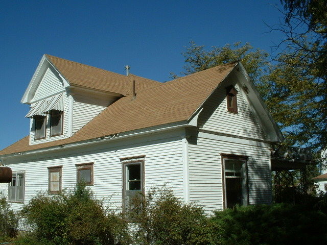

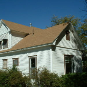

            In the pic of your house, just to the right of the upper window, I see what looks like mildew on the soffit.
            The summer attic temp is a real A/C energy eater. Soffit vents, a ridge vent, and adding a radiant barrier to the under side of the roof rafters (foil side to the attic)can get your attic temps down close to out-door air temp.It does require a good air path.
            Do you have any duct work in the attic?Energy Consultant and author of Practical Energy Cost Reduction for the Home

            The dark spots in the picture are peeling paint .  You can't see it in the pic but it's also happening on much of the siding.  I was initially concerned about interior moisture doing this, but it's happening on wood that has no connection to the interior so I'm leaning more towards poor prep work/paint, a long time ago. (?)
            So, if I don't ventilate, can/should  I run the insulation all the way to the edge of the joists--completely covering the soffits?  Also, should I spray foam around the only ceiling box?

            If you have looked very carefully at the underside of the roof decking, all the way to the ridge,and have not found mold, then you must not have an attic moisture problem. In the attic picture, I see a grey area on the roof decking. Can't tell if it's dust or mold.
            I am a believer in attic ventilation. I don't like to carry a heat load over night in the attic.
            That said, and the fact that you recently moved in, you might want to take some attic temp readings next summer.
            If you do decide to ventilate the attic, I would not remove the window, but would install a gable vent over the other windows and put in a thermostaticly controlled exhaust fan. The attic will need a lot of air intake. The fan box will advise you on how many sq. in. are needed for that cfm capacity. Be very generous with soffit vents, and be sure you have a good air path into the attic from the soffits.
            Do not over power the attic fan, as you will create negative pressure in the house envelope and pull house air out.
            A simpler alternative would be to put a $20 box fan in the gable window and see what effect it has in summer heat. Once again, you will have to provide the attic with soffit air. Pulling the air from behind a radiant barrier would greatly increase cooling efficiency.
            The peeling paint may be an indication that moist house air is escaping into the walls and soffits.
            I would like to see more pic of attic interior and layout of attic floor.Everbody is trying to give you good advice, and the more facts we have, the better the feedback . Paul

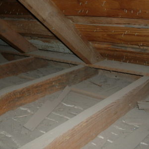

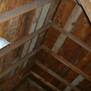

          7. tab1 | Oct 17, 2003 05:13pm | #21
            Paul,

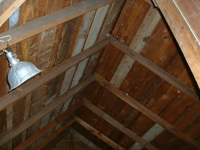

            Not sure if these are what you need but here are a couple more pics of the attic.  I don't see any mildew anywhere--just lots of dirt/dust.  :-)
            We moved here in late spring and I actually did check some temps in the attic this summer.   When it was about 100 outside the attic was always less than 120--which kind of amazed me.  A/C bill was never over $75--which I attributed to being able to frequently open the house at night, to outside temps of 70 or less.   With KS being the windiest state in the union, having cooling 'breezes' at night isn't really a problem!
            < but would install a gable vent over the other windows>
            The attic has only the one (gable) window.  Other windows in the picture are upstairs bedroom.  I haven't yet accessed the tiny space above that bedroom.  Presume it has no insulation, and guess I'm going to have to tear into the ceiling to find out.
            Also, don't think I got an answer:  Is it OK to foam around a junction box in the ceiling, from which a ceiling light is hung?
            Thanks to all for the help.
            Thon

          9. tab1 | Oct 20, 2003 04:11pm | #22
            Let's see if the pics will load today:
          10. fortdh | Oct 20, 2003 05:49pm | #24
            Thanks for the pics.
            I thought I had sent a reply about your foam question, but I can't find it now, so, yes, you can foam around the exterior of a connection box.
            You would benefit from some added insulation.
            Hope the walls of the room that is surrounded by attic are also well insulated. At 120 deg in attic, the room is in an oven.
            If it was my attic, I would add ventilation with at least gable vents.
            Your uncluttered attic is also easy to add a radiant barrier.
            You might ask some of the framing pros on this forum to comment re; adding some collar ties to the roof rafters.
            I would staple a product called Solar Shield across the rafters starting about 3" above the insulation final depth. I would go up one side across the bottom of the triangle formed by collar ties, and meet the shield coming up the other roof side.
            This would channel all the hot air to the "triangle" between the roof peak and the bottom of the collar ties. A gable vent in one end of the triangle would let the majority of hot air out.
            You would need another vent, either gable or soffit, to let air into the attic space below the solar shield. Once accomplished, a natural convection current of air would flow into the attic, pass into the chambers formed by shield/roof deck, and into the "triangle" to exit the gable vent. The hotter the air between the roof deck and shield, the greater the pull for more cool outdoor air.
            This arrangement would let your attic approach out door air temp, would greatly lower the cooling load on the attic surrounded bedroom, and provide a radiant barrier for all the attic under the shield. When the sun goes down, you will be amazed at how fast the attic cools, because you will have eliminated the radiant cooking effect on joists, rafters and even insulation.
            PaulEnergy Consultant and author of Practical Energy Cost Reduction for the Home
