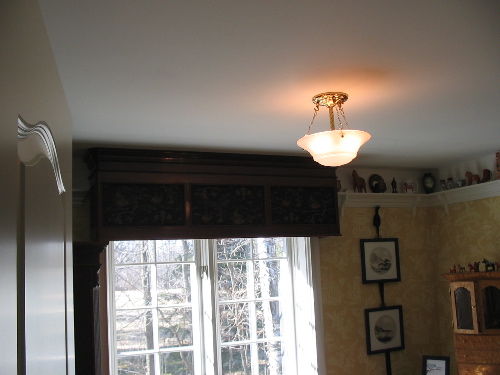

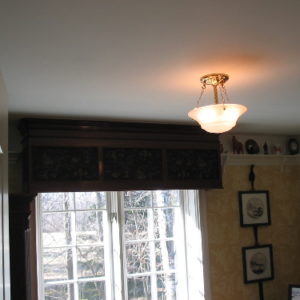

        I often hear people worry about attaching things with the foam. Since it's sandwiched between the stud and the sheetrock, and anything, like a cabinet, is pulled tight to that, there isn't an issue. The only difficult part is putting your screws in straight. They are longer than normal and can't be "horsed" in the way they normally get done. As long as you and a couple of big friends don't do chin ups on the cabinets, you won't have a problem. I keep the blocking flush with the framing. Crown moldings take a little extra care because of the long nails. I recently installed a shelf type crown in a back bed room and used some EZ-anchors rather than long nails, (poor picture). The homogenous insulation makes a big difference in energy savings and it makes the house very quiet. With the windows closed, you won't hear much outside noise.Beat it to fit / Paint it to match
