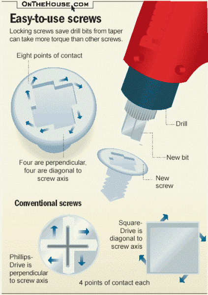

      OK, I'll run with this.
      From the webpage...
      What makes this new style of screwdriver different is that it has been designed with eight points of contact, which is double that of either the Phillips or the square head. The Phillips has four points of contact within the screw head and the square head also has four points of contact within the screw head.
      About four years ago, we met with an engineer and inventor who said he had designed a new type of screw head, one, he said, "that would revolutionize screws as we know them."
      He pulled his new driver bit out along with a handful of screws and it was unlike anything we had ever used. The driver tip looked kind of like a cross between a Phillips and a square head.
      The Phillips is certainly quick and easy to use. The tapered tip makes it very forgiving for the novice (or anyone for that matter) when attacking a screw from almost any angle. However, the taper that makes the Phillips easy to insert is the same thing that makes it hard to hold in high-torque situations where a great deal of pressure is needed to install the screw --as in hardwood or metal.
      We no longer buy slotted screws. For the important jobs that require positive fastening, we have gotten used to using the square head. There is no slip-out (cam-out) and no operator force required to hold the tip in the screw slot (to get a tight high-torque connection).
      Unfortunately, square heads shear very easily and we find ourselves going through tips by the dozens. Basically, the very corners of the square-shaped bit wear down in no time. When this happens, the tip slips and strips (rounds out) the inside of the screw and makes it almost impossible to remove.
      With square heads, it is imperative to change the bit regularly as not to have this cause a problem. Otherwise, the square drive is a great tool.
      Here's the technical mumbo jumbo:
      Phillips: The Phillips tip has four points of contact with the screw (one at the face of each of four surfaces). These points are perpendicular to the screw axis. Perpendicular force is the strongest and provides maximum allowable force. However, the taper of the tip that makes it slip in easily also allows cam-out or slippage when force is applied.
      Square head: The square head tip also has four points of contact (one at each of four corners). These points of contact are diagonal to the screw axis. Diagonal force is not as strong as perpendicular force and shear can occur under high torque. The good thing is that the square tip has almost no taper and therefore doesn't slip or cam-out.
      So, the Phillips is really quick and easy to use. But, it's no good for high torque jobs. The square head doesn't require a truck driver's power to send a screw home like the Phillips does and the square head does high torque driving "fast and tight". But, because there is not a lot of "bite" or grip surface with a square head it takes about 10 bits to do the job you would expect from one.
      The new screw tip looks like a cross between a Phillips and a square head. Actually, four little square heads clustered together and slightly offset from center (and each other). Thus, the screw offers eight points of contact. Four are perpendicular to the screw axis like the Phillips and four are diagonal to the axis like the square head. There is almost zero taper, so the tip doesn't cam-out and because of the perpendicular grip feature the screw tip doesn't wear out.
      Here's a real caution. Be sure to use this tip/screw combination with a reduced torque setting. Without setting the torque on a driver drill you can literally break screws all day long.

        BossHog | Sep 30, 2005 09:41pm | #7
        I don't see the advantage. Seems to me you have 8 SMALL points of contact with this new kind, instead of 4 LARGE points of contact with square drive. So there's no real advantage.
        Know how do you drive an engineer completely insane? Tie him to a chair, stand in front of him and fold up a road map the wrong way.
          CapnMac | Sep 30, 2005 10:53pm | #12
          And, I'm still figuring out how this will turn when you can quite get teh bit , 'cept at that, ugh, over a bit, up some, getcher e'bow right theya, angle that is occasionally needed?
          Next question I have.  So, I've got this next wonder of the world bit--howsat going to make the cheap, discounted, only been rejected the once by People's Glorious Screw Fastener Plant #1159 screwheads from snapping off under torque?
          The heads come loose because there's a weak spot there, not because our driver bits are so good (to paraphrase our sage on the archimedian fastener, Piffin).Occupational hazard of my occupation not being around (sorry Bubba)

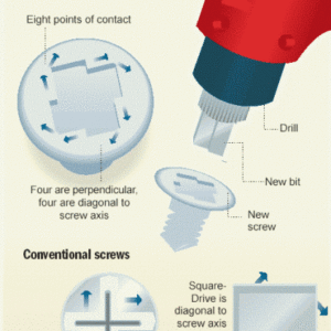

  4. ZooGuy | Sep 30, 2005 10:38pm | #11
    Maybe I'm being thick on Friday afternoon but something doesn't make sense. In fact, it looks like sloppy marketing hype. How can they say that a Phillips drive is perpendicular to the head axis but a square drive is diagonal? Since the screw is round aren't they choosing an arbitrary x-y axis to reference perpendicular? Why can't we rotate the Phillips x-y axis 45 degrees and call it diagonal to the screw axis? Ain't nuttin changed except an arbitrary line.
    If I'm missing something obvious you have permission to whack me upside my haid.
      EricPaulson | Sep 30, 2005 10:58pm | #13
      Yeah, my head started spinning on it's axis trying to make sense of what they were saying.It's Never Too Late To Become

      1. GOLDENBOY | Oct 01, 2005 03:31am | #22
        We are turning the screw, so the force must be applied tangent to a circle, the centre of which is the axis of rotation.
        1. DanH | Oct 01, 2005 03:45am | #23
          Ah, there's the problem! Come up with a screw where you apply the force radially, then you could use a round bit!
          1. Snort | Oct 01, 2005 04:08am | #26
            Interestingly enough. I have a 3" roberson tip that I can't wear out either. Subbed a cabinet job seven years ago, and the cabinet builders gave me the tip. I didn't even have a Kreg jig at the time, but this tip is perfect for pocket screws. I've used the bejeezus out of it, but lately I've been trying to ease up on it. It can't last forever, can it?I like the torx, but it pizzes me off that they make two size bit holes in the same size heads. Of course, I always have the wrong one<G> I like the screws though, the bits will snap off before the screws are damaged. Bosch is the crappiest.For shorty #2 square drive tips, the DeWalts have held up the best for me, McFeeleys have been the worst.Rez, wtf did you have to show me another one for? "what's in a name?" d'oh!
      2. FastEddie | Oct 01, 2005 04:32am | #27
        Ok,looking at the new goofy screw ...
        Draw radials from the center of the screw, like spokes on a wheel.  If you draw a perpendicular to the spoke where it meets the contact point, half of the contact points are at 90*, the other half are at 45* or somthing else.
    2. BillBrennen | Oct 01, 2005 11:51pm | #33
      ZooGuy,Post #28 says it pretty well; I just wanted to expand on it.On a slotted screw, the ends of the slot are loaded almost at 90 degrees to a radial line when driving the screw. Similar with the Phillips. The corners of a square (Robertson) recess are actually being loaded at 45 degrees to the direction of torque. The 6 lobes on a Torx are also loaded at an angle to the tangential torque. The newer Torx-Plus bits and screws have a lower angle of force offset, and can take more torque because of it. Given the good recess styles we now have, I concur that this new system is a solution in search of a problem. Besides, it is ugly. I prefer the symmetrical look, personally.Bill
      1. 4Lorn1 | Oct 02, 2005 03:01am | #34
        Re: " Besides, it is ugly. I prefer the symmetrical look, personally."I hadn't considered the aesthetics side of the situation. It is a very powerful force. Often to the extent that it can overwhelm the practical side of the equation.A good example was the development of the AR-15. Simply put it was/is sexy looking. It has a streamlined, high tech, modern look. Some historians of firearms design have noted that if it was uglier there would have been less tolerance of its flaws and the program may have been dropped before the problems were corrected. Over time it became a respected weapon with a personality that approximated its physical beauty.'You can't kill me. I'm too pretty to die.'
      2. JohnSprung | Oct 04, 2005 01:25am | #49
        Yeah.  The design does kinda remind me of the symbol of a certain German political party that was in power from 1933 to 1945.  (The dirty word filter freaks out if you use the short version of National Socialist German Workers' Party.)
        -- J.S.

    rjw | Oct 02, 2005 03:29am | #36
    "four are diagonal, 4 are perpendicular to the screw axis"
    Huh? The more I think about that statement, the less sense it makes.
    I'll take a well fit phillips to a poorly fit anything else, myself.
    Sojourners: Christians for Justice and Peace
    1. HeavyDuty | Oct 02, 2005 04:23am | #39
      Post 28 explains it.
      Another case of engineers can't communicate their thoughts.
