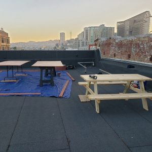

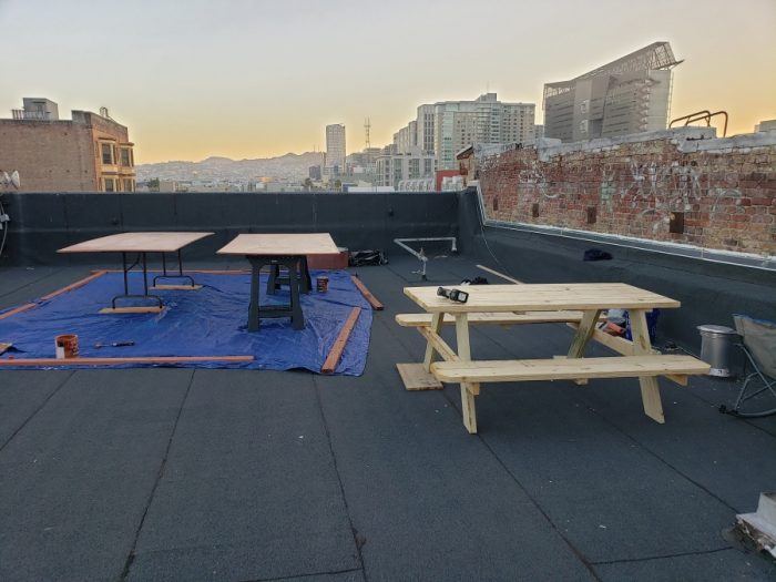

  3. wrybreadsf | Jun 14, 2022 11:24pm | #5
    The story so far, see attached pic. A surprisingly shoddy Lowes picnic table with lumber that looks like it was cut by a gorilla, and the two plywood planks that will make the deck being painted. Giving them lots of coats.
    I can't decide whether to mount the 2x4's under it vertically (the normal way for a deck) or horizontally. I'm thinking horizontally will be easier on the roof since there's more surface area and there's a bit of flex. But horizontally might lead to warpage...
