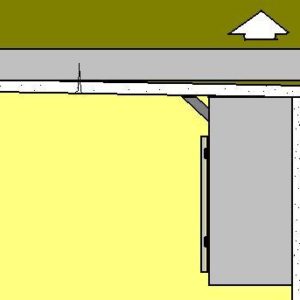

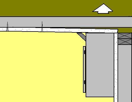

Sledge, the drywall wasn't installed according to truss manufacturers recomendations to reduce the effect of trusslift. There really isn't a way to stop it, so the best you can do is float the drywall. Your's isn't floating, it'd fixed tightly to the trusses.
Go up in the attic, bring a sawzall and release the drywall, then fasten it to the cabinets.

So do you think it's truss uplift or not?If it is, either you have to fix the uplift, release the GWB from the trusses, or live with it.Floating out the gap with mud will not work, since what goes up will come down.
You and the building inspector should do a bit more reading on screw placement on ceilings when trusses are involved. It's a fairly simple system, one that will allow the drywall to float at the corners. You don't need any fasteners near the interior wall edges because the drywall sits on the wallboard that you installed on the walls. It would be impossible for it to fall unless you were very horrible at fitting it to the edge. If you didn't install glue or fasteners for the last 2', it would rest comfortably on the wallboard that is installed on the walls. When you set your cabinets and trim and caulked it, it would hold tight to the trim. Since you knew you were going to put 12" of cabinet, you should have left the last 3' loose.

Have you realized that the problem is 18" away from the walls, at the front of the cabinets?So the drywall detail you keep talking about would make no difference in this case.

Yes, thats why I told him that he should float the drywall for about 3' from the wall. The trusses have probably uplifted 3/4". Thats how much mine used to. If the drywall stayed down at the wall, it probably would still be down at the 12 and 18" mark.

You are so fixated on fastening the drywall tight to the trusses, that you fail to realize that your 24" cabinet is plenty strong to support and hold up the drywall. In your case, you could easily float a very large section of drywall knowing that the cabinet will be the ultimate support.
I really don't care if you refuse to believe the fix. You're the one that has the gap. You have to pick your poison. Either release the drywall, or live with the gap. The only other solution was to float the trim, which is a very logical solution, but you already indicated that that wasn't a viable solution. Your going to have to prioritize your needs and settle on something.
Or, you can enjoy that 3/8" gap. I'm sure they make caulk flexible enough to strecth with the seasons. I'm sure that look will be very satisfying to some, but I'd prefer to float the drywall.

The drywall may well be installed per spec. But if the cabs are 18" deep and the DW installer held the nails 2' away from the walls, you're still going to see most of the uplift at the front of the cabs.By "full overlay" I assume that means that the "cove" is just a dummy strip the same thickness as the doors, and flush with them. If you attach it to the ceiling you'll then have a 3/8" gap above the doors (or else, if tighter, have the doors jamb when the ceiling drops back).If you really, really had to fix this in the worst possible way you could knock the ceiling loose from the trusses and hang it from new joists, with their ends resting on the partition wall.

You may not like the solution but if you want to fix it, you will have to float the sheetrock. As Blue suggests, fastening it to the cabinets may be the only way to solve this problem.
