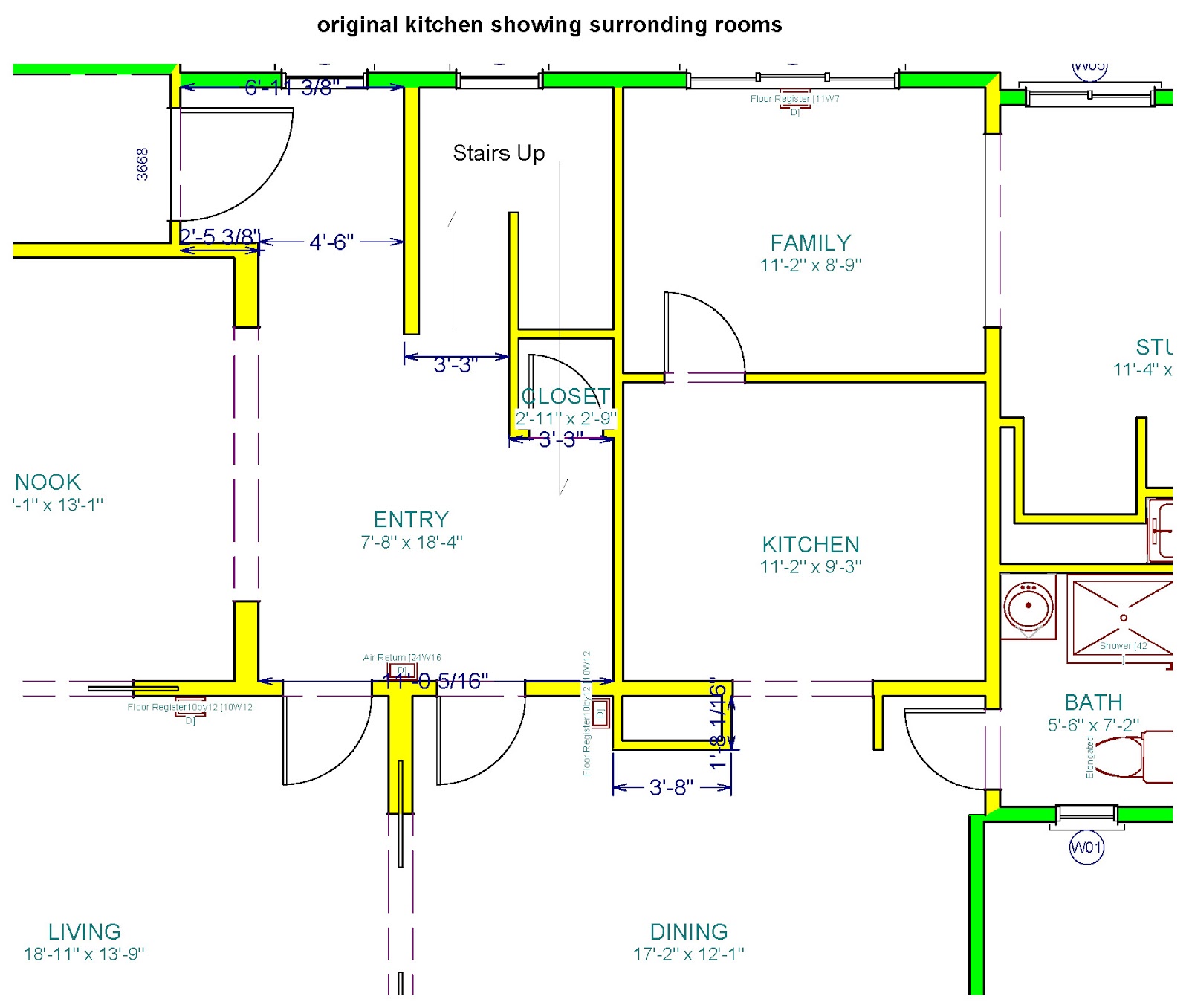

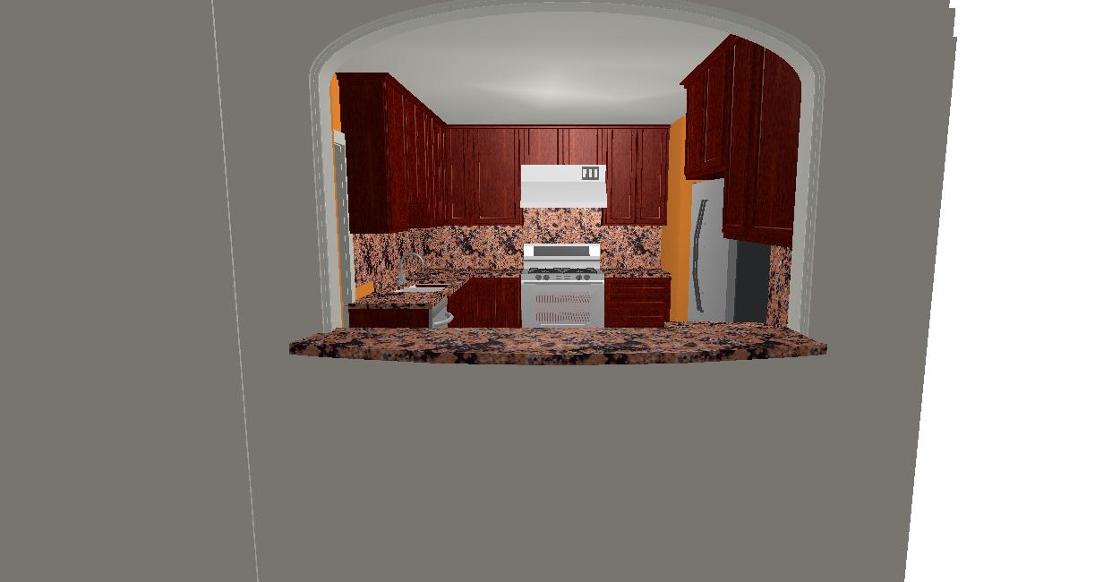

Here’s what the kitchen looks like and the surrounding area.
From above you can see the family room, the entryway and unfortunately I cut out
most of the dinning room that is where the entrance to the kitchen is. We don’t want
to push into the family room as we love the idea of a separate sound proof space to
watch movies in. We don’t want to push into the dinning room as its all original and
well, we actually use it. That leaves the entryway we think…

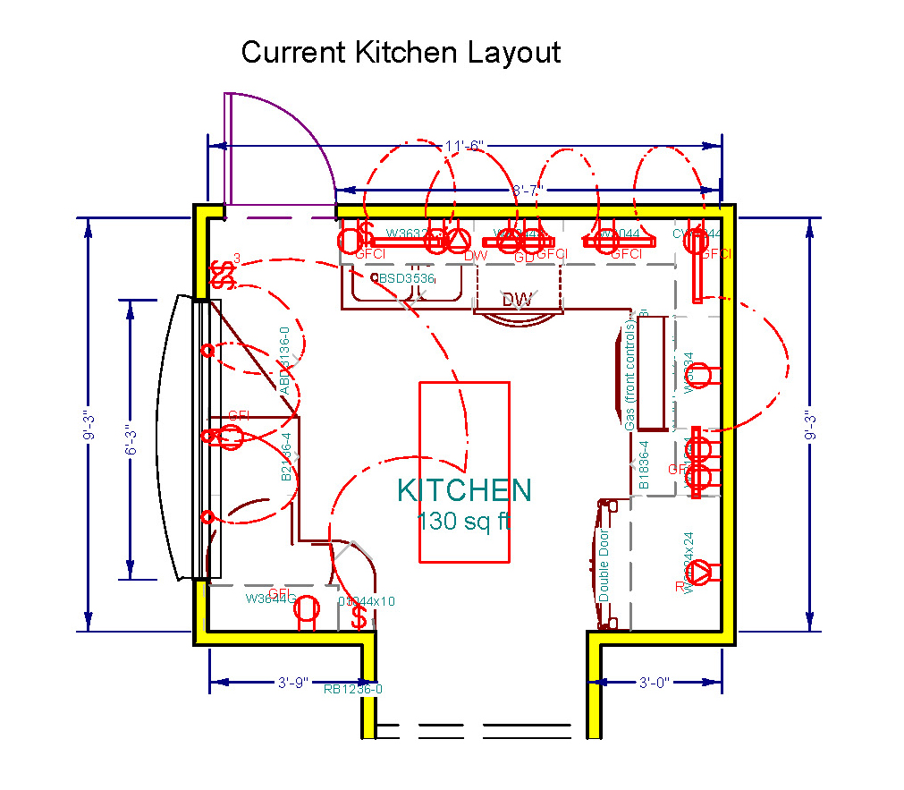

Here’s what the existing kitchen looks like now.
For the record I F’ing hate the existing kitchen. It’s waaaaaay to dang small and poorly
laid out. We have to put our baking stuff, most of our small appliances and all our
Costco overflow in the dining room.

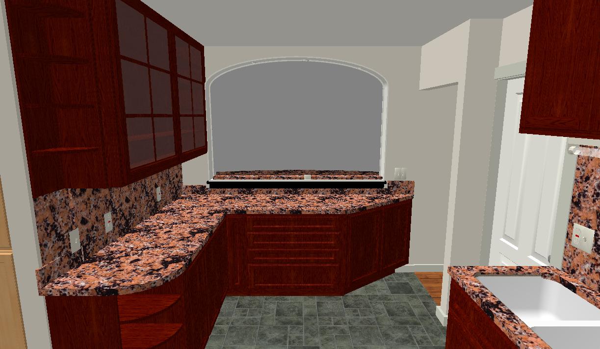

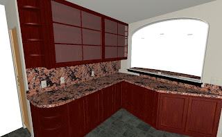

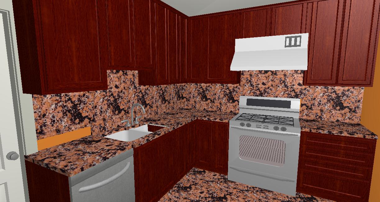

Here is what the new long wall with the acute angle could look like.
Here is the stove wall.

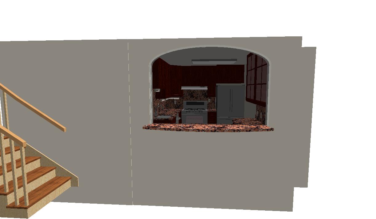

Here is looking at the pantry corner from the opposite corner.
A straight on view of the pantry, counter area.

  1. calvin | Mar 29, 2012 06:00pm | #1
    The range is too close to the left side-the door may well hit the DW.  No work room to the right.
    The refrig, if it is that big will not allow the door to open all the way, unless you have one that's zero clearance on the sides.........
    and then you need to make sure that the drawers will pull out w/o the door opening past 90.   Just recently found an electrolux that is made just that way-the inside door shelves are not as deep low down where the drawers pull out.
    Something to check for sure.

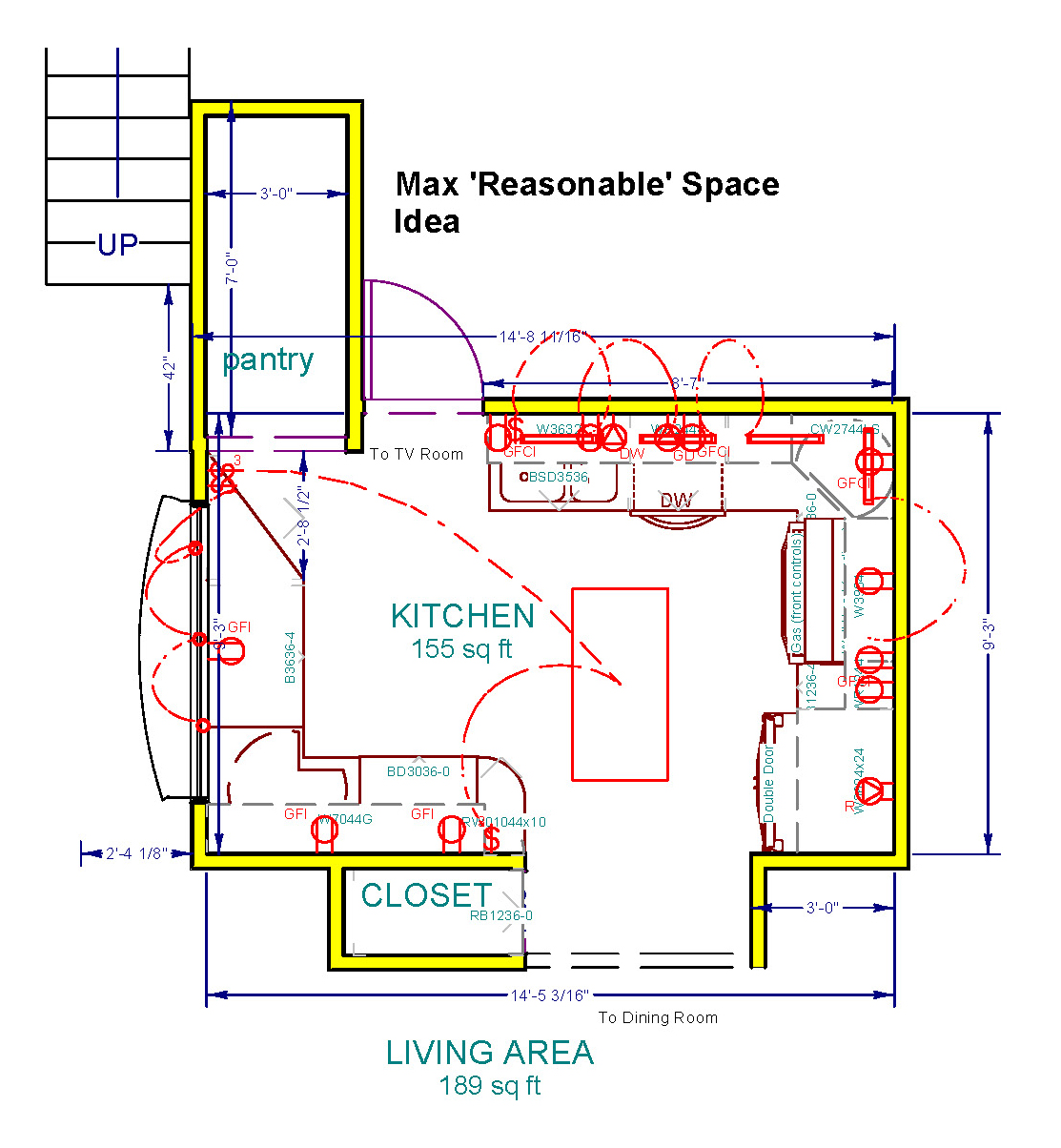

      madmadscientist | Mar 30, 2012 04:26pm | #5
      Hello
      We've moved on from the crazy angle idea to this probably more sensible idea.
       As you can see with this probably more sensible version we lose 2'-4" along that wall.
      There is also 2'-8" clearance between the cab and the pantry door.
      As to your initial concerns.
      We've lived here for a year and I do all the cooking and cleaning and I never realized that the stove door would hit the DW door when they were both open. I went downstairs and yep you're right. But I'm thinking that its not really an issue..not ideal for sure.
      Our fridge does have the zero clearance hinges.
      Everything in the picture is to the exact scale.
      What we're trying to figure out now is, if pushing the West wall (N is up in all my diagrams) out the 3' and bringing the pantry into the kitchen is worth the hassle. The East and South walls are loadbearing and can not be changed easily.
      Thanks for your reply.
      1. DanH | Mar 30, 2012 08:40pm | #13
        I'd move either the fridge or the range to the other side.
      2. JimB | Mar 31, 2012 11:37am | #16
        Think about reversing the DW and the sink so that
        you have counterspace on both sides of the sink.
  2. JimB | Mar 29, 2012 06:25pm | #2
    I think that the acute angle in the cabinets would be a real
    pain in reality.  Reaching the upper cabinets all the way against the wall will be difficult.  Have you considered keeping a right angle in the cabinets and then tapering the depth of the cabinets as you move away from the corner?  Not necessarily a great idea, just trying to help you brainstorm.
  3. DanH | Mar 29, 2012 07:57pm | #3
    It may be the best you can do, but it sucks.  The fridge won't open, the stove is too close to the fridge, the acute corner is going to be a PITA.
    At the very least put a fillet in the countertop and lower cab for that corner.

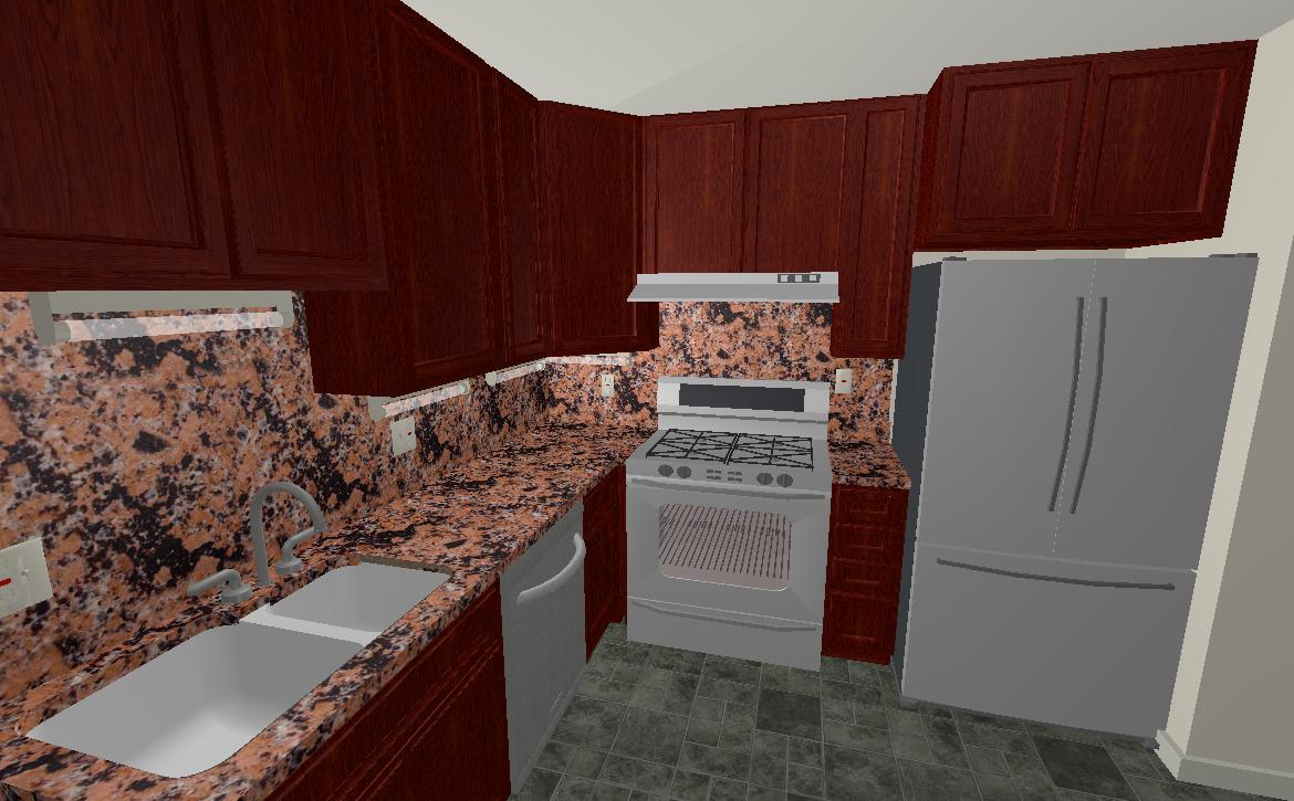

    Current Design Fav
    Okay after much internal discussion here's where we are at.
    The new hallway idea under the stars is out.
    Right now we like the 'most reasonable square foot' idea.
    For reference here's the existing kitchen
    Several people have been confused about whats around the existing kitchen so here's a slightly bigger version of the floor plan around the existing kitchen.
    We're still up for different ideas for folks who want to try their hand at moving walls.
    Here's the blank slate version of our current fav wall layout.
    We would love it if someone wants to take a stab at completely redoing the kitchen layout.
    I think we are having trouble seeing past the existing to what could be.
    The only design constraint is that those are our actual appliances and they have to fit and we want to keep a breakfast bar kinda thing roughly where it still is.

  8. IdahoDon | Apr 02, 2012 01:50am | #23
    Looking again at that rendering that showed the accute angle - I don't care for the angle, but I do like what you're doing with that wall - how about a slightly bowed wall?  It reduces the angle, adds interest to the wall and opening and maximizes the kitchen space while allowing good access to the stairs still.
    Last summer I built a floor to ceiling curved set of cabinets that took the place of a wall that I realy liked after the fact.  On side of the "wall" was smooth while the other had normal cabinet stuff - looking at it you'd never know the "wall" was actually all plywood and we were able to be built everything 4" deeper than if the cabinets were simply butted up to a stud wall. That's a significant amount of extra storage along a 10' section - even with the large opening in your plan.
      madmadscientist | Apr 03, 2012 05:53pm | #25
      Lets see if I can get this to work here...
      That's the total existing floor plan for this floor.
      I know its a wonky non-modern floor plan but it works for us quite nicely. We have the fancy public spaces and the more casual private spaces on the same floor.
      The rooms marked nook, dinning, entry, and living are the original fancy Victorian rooms of the house which have details that we do not want to mess up. The layout is funky but it works for us. We don't use the front door at all. We come in and out the back door. The family and study rooms are really our TV and kids playroom. This was originally its own studio apartment so its pretty well soundproofed. Every weekday we have three toddlers here plus the baby sitter and this arrangement has worked out well for us.
      The pass through to the entryway is really a breakfast bar that we use all the time. We like it there as without it the we feel that the kitchen would be a dark cave.
      1. calvin | Apr 03, 2012 05:59pm | #26
        What pass through
        Is that something you showed b/4?
        And that picture is way too big-why not edit down to a size that we can see it all w/o scrolling?
          madmadscientist | Apr 03, 2012 06:15pm | #27
          Nope
          I've never shown the full floor plan for this floor.
          I'll try to edit it down give me  couple secs...
          1. calvin | Apr 03, 2012 07:46pm | #28
            Yes, I realize the full v. partial plan
            But what I asked was, where is the pass through / breakfast counter in this drawing?

            madmadscientist | Apr 17, 2012 05:20pm | #36
            How about this idea?
            I've had a lot of imaginary friends helping with the redesign of the kitchen....ahem
            Here's a slightly modified floor plan for the kitchen.
            What's different here is that we've moved the fridge to a new wall and recessed it into what was originally going to be some sort of broom-trash storage closet.
            We also flipped the DW and the sink because EVERYBODY says you can't have a sink at the end of a run of cabinets....
            I like this idea because it frees up space around the stove...but now I'm not sure where the broom closet stuff is supposed to go?
            Where can we put the mop, broom, trash and recycling bins?
            We Still Need Help With The Closets-Pantries.
            Here's a different shot of both closets and the appliances we need to fit.
            How can we best utilize the space in the pantry closet for bulk storage and small kitchen appliance storage...and now possibly broom closet stuff also?
            Pretty Pictures.
            Here's what this current design looks like if you are standing at the stove and looking back at the rest of the kitchen.
            Sorry about the odd color walls...but the granite and cabinet colors are spot on for what we have now....yes our kitchen has a silly amount of granite...
            Here's how it looks standing at the corner by the fridge and looking back.
            Yep, lots of granite....
            Here's how it looks from the dining room entryway looking into the kitchen.
            And here is how it looks if you are standing in the entryway and looking through the breakfast bar opening and into the kitchen.
            So, whats everybody think?
          3. calvin | Apr 20, 2012 09:46pm | #38
            I think.........
            that you finally opened your mind to this remodel and instead of saying why not-you've actually started to "think" about the project.
            Now, only the sky's the limit.
            best of luck.
          4. calvin | Apr 20, 2012 09:50pm | #39
            But..........
            Take a look at this positioning-
            The right frig door-unless you can get the door "stop" (if there is one) to keep it from opening past 90 deg, it'll bang into the counter (because it's recessed more than usual.
            Great idea to get it out of the way, but may be problematic.
            madmadscientist | Apr 20, 2012 10:07pm | #41
            ya
            The folks at garden web pointed that out also.
            I'm thinking that for the base cab there I will have to go with a 12" deep model.
            The fridge is recessed so that its even with the 12" upper cabs to the side.
            I was initally unsure of this because we really use our big deep over the fridge cabinet a lot...
            But then I realized that I could still put in a deep cabinet but it too would be recessed.
            Still not sure what to do with trash, recycleing and broom closet stuff with this new idea.....
            thanks for the reply.
          6. calvin | Apr 20, 2012 10:25pm | #42
            Deep frig cab?
            Is that wall load bearing?  If so, you'll have a header in there-or you'll be burying all or most of it in the ceiling.
            If not bearing, you might have at least the plates to contend with (hollow out to top of the cab in that spot).

  10. eastudio | Apr 20, 2012 09:25pm | #37
    some more info
    do you guys have the entire first floor plan? and are you certain which are the structural walls?
      madmadscientist | Apr 20, 2012 10:04pm | #40
      earlier
      in the thread there is a giant picture of the entire floorplan that I can not seem to shrink for some reason.
      The walls I have indicated are indeed load bearing as verified by my SE.
