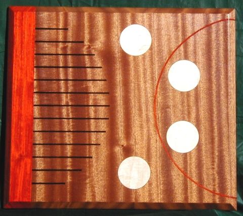

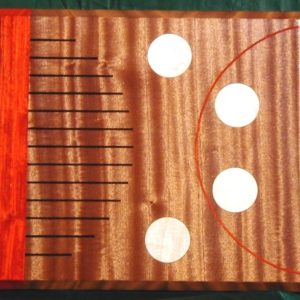

  6. splintergroupie | Jul 19, 2006 10:44pm | #13
    I use a hole saw in a drill press (not the flimsy one with the 1/4" shank, but the closed circle of rigid steel with the hexagonal shank mandrel) to cut the plug, then the appropriate size Forstner bit drills a hole in the substrate. I found several hole saws and Forstner bits that would give the plugs a tight fit. Depending on the color of the woods, i either use epoxy or polyurethane to set them; epoxy dries with a darker ring, while poly has a lighter tone.
    Here's an example of hard maple plugs set in mahogany in a table top about 16" on a side, with 2" plugs:
