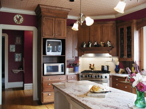

The Cabinet co. took some pics and put one on thier web site.
I’m gonna try and get some more.
http://www.customcabinetree.com/photo_details.asp?PHOTO_ID=155
Nice cabinets But I dont like the finish.
Kinda blotchy and no depth at all.
But these folks had thier own tastes, and they are happy.

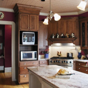

        t.. one of the guys here showed me how to do this...here's your kitchen...i hope..
        cool , huh?Mike Smith   Rhode Island : Design / Build / Repair / Restore

    I like the cabinets and the design, not sure on the wall color though.

            The problem with that idea is that the light and shadows in a room change the hue and saturation of a color at various places in the image. What I typically do is create a mask, find the predominate hue in the color I want to change and shift that hue toward the color range I'm looking for until it closely matches the paint chip I have taped to the side of my monitor. Here is the original image in the thread with plumb walls for example - about 10 minutes or so worth of tweaking.
            I use a combination of Photoshop's Hue/Saturation, Levels and Curves adjustments to get the end result I want. I've found that tweaking the individual colors in Hue/Saturation is usually the most effective way to dramatically shift a specific color in a photograph.
            The other big trick is calibrating the RGB monitor and the CMYK printer to "render" the same colors. Most digital artists get pretty psychotic if they catch you tweaking their monitor/printer calibrations. Once it's close you don't ever want to buy a new printer or monitor and you stick with the same brand replacement cartridges with determined resolve. It is a serious pain to re-calibrate!Kevin Halliburton

    What is the purpose of the top of the cabinet which houses the TV and the microwave. I see it goes all the way to the ceiling like a kind of chimney or ventilation shaft?
    John
    1. MisterT | Dec 30, 2003 03:24pm | #8
      You would have to ask the "designer".
      It is just a cab that goes all the way to the ceiling.
      IMNSHO this whole project was one bad design on top of another, all will ugly paint!
      Between Bossman's terrible layout /wasted space and Kitchen design, these people spent 300K and didn't even get a Master bedroom suite they wanted.
      But I don't want to get started!!!Mr T

        that one at least shows some lighting.
        many you see do not seem to be well lit, cept for a hanging fixture with a bulb or two

    I installed the cherry cabs like the pix on the left in the last house I did.They were gorgous....what kind of wood were the blotchy ones and was the blotchy look on purpose? Spose to look old?
    What is that ceiling?
    You did a real nice job.....hope you were paid well for it

      They were Maple cabinets the finish to me seemed like just stain and no Topcoat.
      Verrry Flat finish, which makes splotches look worse to me.
      Cieling is 2x2 tin panels.
      boss ordered unfinished to save $$ but Painter had to spray-prime them front and back and then spray to whole thing after it was up.

        kind of odd that they didn't put a conditioner on before the finish to keep it from blotching up.
