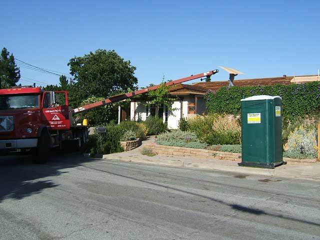

When they delivered my roof sheathing it came on a truck with a long conveyor belt/boom thing - one guy feeding and one guy pulling on the roof. Slick!
