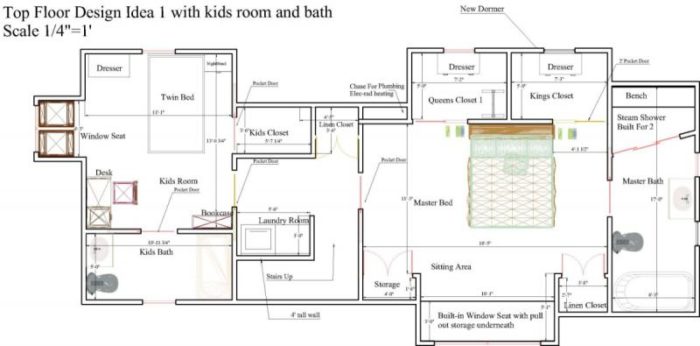

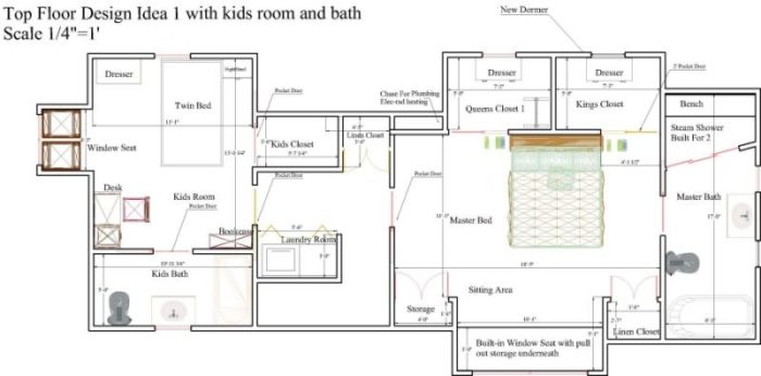

Here’s our best attempt at designing it all out.<!—-> <!—->
 View Image <!—-><!—->
We’ve added a dormer opposite the existing dormer and put our closets in it.
We kinda like the idea of having windows in the closets. Not sure about the sizes though.
Putting the bath were we did in the ‘kids room’ squeezes the size down but it still seems like a pretty good sized room.  <!—-><!—->

  2. USAnigel | Dec 22, 2008 04:24pm | #2
    I'd go with idea 1 but with king and queen closets 4 foot deep and twin vanity's. Get rid of the door at the top of the stairs, if you can. No TV in the bedroom, if you can live with out it.
    Or professor ideas seem crowded, might look better drawn to scale.
      madmadscientist | Dec 22, 2008 09:02pm | #4
      Why 4' deep closets instead of the 5'?
      yes I agree the archs. ideas turn the MBed into a series of winding paths which we are not super happy with.
      The double vanity thing....EVERYONE says you need one be we're not sure.  We don't use the bathroom at the same time really so we don't see the need for one.
      Ya no TV in bedroom wifey-poo won't allow it.
      Daniel Neumansky
      Restoring our second Victorian home this time in Alamdea CA.  Check out the blog http://www.chezneumansky.blogspot.com/
      Oakland CA
      1. USAnigel | Dec 22, 2008 09:31pm | #5
        4' deep to give better walk way to the bathroom is what I'm thinking.
        Twin sinks cause in my house I'm always moving "her" junk to get to a sink. We do tend to go to bed around the same time.
        No Tv cause I like to get away from it at times.
        Make sure the steam shower is built correctly. Lots of details for long life.

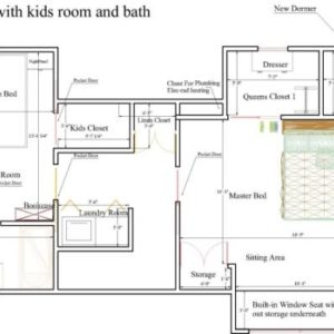

            Okay here's the newest version of how we are going with the top floor.
            We're pretty settled on the kids room and the closet being the way it is.  The kids bath size is pretty settled but not the exact lay-out of the bath.
            Opened up some space in the master-bed by getting rid of the couch and table and putting in a big window seat with big pull-out drawers underneath.  We both really like the idea of having somewhere comfy to read that's not in bed. The closets on either side of the window seat are kinda optional but we like how they frame in the window seat.
            We got rid of the door at the top of the stairs and turned the queens closet #2 into a shallower linen closet.  Hopefully this will make this area less cramped feeling?
            Still have the closets in the dormer.  THere is 4' between the bed and the wall on the tight side that gives me 2' for a nightstand and 2' for a pocket door.  This does not sound ridiculous to us?
            Didn't really screw anymore with the master bath.
            Now that the 'pro' has the real dimensions of the space we'll see what he can come up with...

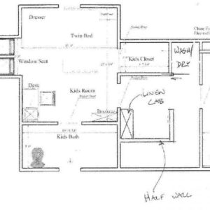

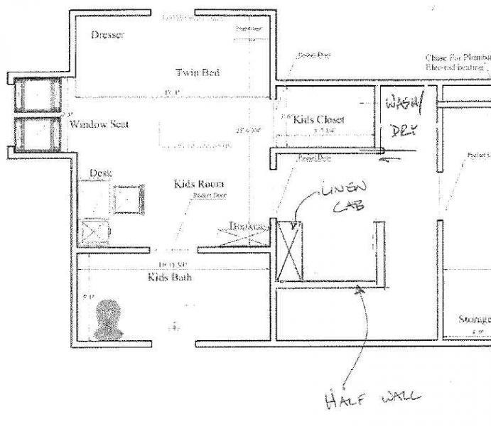

          10. draftingguy | Dec 30, 2008 03:47am | #19
            I tend to agree with Mike Maines on the configuration of the hallway - more open might be better.  How about this?
            Or maybe you could have base cabinets and countertop along the length of the half wall, which would allow for linen storage and a folding space.

            That's interesting.  Put a stacked washer-dryer in the closet.
            The half wall could even be a railing to maximize the 'open-ness'...
            But then that little nook area seems like wasted space a bit... Wife says-where's the detergent going to go and where do we fold the clothes?
            thanks for the input we appreciate it.

          12. draftingguy | Dec 31, 2008 12:16am | #21
            I added a quick thought below the picture in my last post that would cover both of those bases.  Instead of having a tall linen cabinet like I sketched, you could add base cabinets and countertop along the length of the half wall.  You'd get linen and detergent storage, plus a folding surface.
          13. fingersandtoes | Dec 31, 2008 04:37am | #25
            "you could add base cabinets and countertop along the length of the half wall. You'd get linen and detergent storage, plus a folding surface."Or leave out the base cabinets and put in front loading machines under the countertop. Lots of possible variations, but I think you and Mike are right: opening up the stairs would make a big difference to how the upper floor relates to the rest of the house.

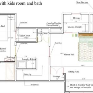

            Okay so here's our latest design for the top of the house.
            We got rid of the wall where the washer and dryer are and the doorway at the top of the stairs and we've moved around the sink-toilet in the kids bath.  Yea the dormers are still a little wacky with the bed not centered but this is the best we've got so far.

          23. mike_maines | Feb 01, 2009 09:06pm | #31
            Thumbs up--looking good!
            You might put a 1/2 wall next to the master toilet--it might feel out in the open otherwise.
            You have a lot of pocket doors.  They can be a great space saver, but they also mean that you can't have a wall switch there, they're harder and more expensive to install, they are more awkward to use than a swinging door, and they transmit more sound than a regular door.  I'm not saying don't use them, but you might not want so many.
            Other than that, no complaints here.  Are you and your wife happy with it?
          24. User avater
            madmadscientist | Feb 01, 2009 10:56pm | #32
            Yep i do believe we are.  SWMBO is afflicted with this condition where she won't be a happy about a decision unless shes sure shes looked at ALL the possible permutations.....but she seems to be happy with it.
            On the pocket doors...I'm hoping the johnson hardware pocket door kits will help with some of those issues...

          35. wrudiger | May 27, 2009 04:12am | #44
            Yea, intere$ting journey!  Not too surprising that you pretty much ended up where you started - a good designer really listens, without ego, then turns what they hear into something that will actually work - for you.  Still sucks the number of iterations & cost to get there.  To say nothing of the fact that in the end it is essentially unaffordable - argh!
            I really like how the top floor turned out - sometimes one or two tweeks and it all clicks.  Less excited about the kitchen, but it's pretty much a shoehorn job given your constraints so I'd say it's about as good as you could hope for.
            As someone who seeks quality, efficiency and durability to say nothing of aesthetics - on a Blitz Beer budget - all I can say is patience is a virtue!  Hang in there, and give that baby another hug.

            We do  like the idea of having a quiet place to read so I think we would use the sitting room area.
            We went through this recently. Our new bedroom had a similar space to what you are calling the sitting room area. I built in a window seat in front of the windows, with drawers underneath. The seat is flanked by two narrow built in cabinets with drawers below and open bookshelves above. The result is a cozy seating area and quite a bit of storage space.
            If you just put a sofa in the space, you don't get any storage. In addition, the window seat, etc. is pretty easy to do yourself and considerably cheaper than a decent sofa would have been.
            edit: I just noticed that the design incorporates the window seat. As to cost, can you have the builder do most of the work and just do the cabinets, window seat, etc. yourselves?

      2. klhoush | Dec 23, 2008 10:57pm | #8
        I like it the way it is now more than any of the drawings. They are too busy and closed down. If you sold the house, the buyer would tear out all the new walls and open up the space.
        You have an 8' high knee wall, why not put a wall of doors on it so you don't have to walk in? I don't like standing around in closets.
        What direction is east? A little morning sun will make me rotate a floorplan. Closets on the north if possible.
        OB
          madmadscientist | Dec 24, 2008 02:57am | #10
          The way it is now is gutted and unusable? Do you mean the second floorplan with the bath in the kids room?  We also like this idea the best because it is more open.
          East is the 'top' of the diagrams so the windows in the closets would be getting the morning sun and the big window in the sitting area would be getting the evening sun.  To tel the truth we are not big fans of mornings so having 'extra' morning light is not a high prioity for us...
