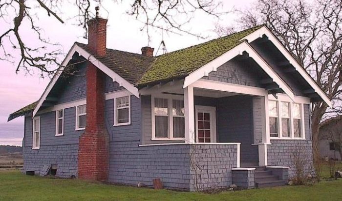

I’ve got to replace my roof this season (it has lovely lichen-covered cedar shakes now) and want to use standing seam galvanized steel (prominent local supplier sells Champion, can’t remember if it’s 12″ or 16″). House is 28×42 with gables facing 4 ways, two intersecting ridges, and four valleys. Roof is 7/12. There are short sections of eave at both ends of the long dimension, but I think there’s less than 35 feet of gutter on the place. Rafters are 2×6 and are sagging visibly the way rafters in all old houses sag. There is 1×4 skip sheathing on now and I assume I would add 1/2″ ply after stripping the cedar.
Never done a metal roof, so I don’t know how challenging it is (supplier says it’s easy but he wants to sell stuff) and I’m not sure how the panels will lay on the concave roof surface. Lots of angled cuts for those valleys, too. Whaddya all think?
Pic attached–no, we don’t have to fertilize to get the lichen that color.

Sorry, that photo is from the pre-obsessive-compulsive era, during which I tore the place up. The chimneys are gone. Roof penetrations are: two plumbing vents (2 and 3"), one 3" B vent for the water heater, and one future vent for a propane heating stove (6" or 8" I assume), one skylight, one possibly one roof hatch so I can get on the roof from the attic (client's house had, that, molto bueno).

I think the metal panels would have what they call an "oil can effect" if your rafters are bowed.

That's a quaint craftsman bungalow. I like shigles for them for appearaance.
I can't see too much sag to the rafters in the photo, but I would suggest straightening things out before putting preformed pans on it. Standing seam takes a bit of patience, especially to startout with, and the dimples from uneven surface will make it harder to get the hangof and will not look classy at all.
I would either strip dow enoguh to sister the rafters straight and plywood new, or leave shingles in place and lay 1x4s over them on pattern with shims under to straighten the plane of the roof out. Then the roofing could be fun again.
But I still think shingles will look better on that place.

Cedar roofing in this neck of the woods always gets that lichen growing on it, and you can't walk on it without pulverizing it. I agree it looks pretty good and I guess I might replace it in kind if it didn't get so... toasted. Since the photo was taken the sidewalls have been re-shingled with alternating 5-1/2" and 2-1/2" exposures like the gables. So, we gots lotsa cedar showing now.
I definitely want to strip the roof, because it's just not my nature to leave old material under new. I could straight-line things by installing the plywood over shims rather than directly to the skip sheathing. Then the metal would have something relatively flat to lay on.
i would sister a new alongside existing to remove sag, instead of shimming. once you have stripped roof of shingles it should be fairly easy to install new rafters alongside through the gaps in skip sheathing. just tap the skip sheathing up for clearance where old rafters have sagged so you install sister to correct height above existing, then re-roof as is your choice.
you definitely want to address sagging when you change from cedar shakes that hide a multitude of sin to a material that will show off every imperfection, and if you are even slightly obsessive/compulsive it has to be perfect or a little bit better. i would want to take every practical step i could to make sure it didn't sag again, including but not limited to bracing and blocking in addition to sisters.

Just went up in the attic for something else. The common rafters look to be about 14 feet long and have less than 1" of deflection in them, by eye, I did not pull a string. If I pulled the skip I'd have to do a lot of flocking around to install the plywood. The house was not built with precise stud or rafter layout, and applying any sheet materials is a headache. With the skip in place I could at least consider letting the joints fall where they may.

If it's sagging an inch in 14' and you want to use standing seam then you will have to straighten them out at least to within 1/2" but even that would be noticeable.
If you just wanted to be done with it then I would deck it and put on some good quality architectural shingles to still keep something of a cedar shake look to it.

sounds pretty nice: do you have any current photos?
<taken the sidewalls have been re-shingled with alternating 5-1/2" and 2-1/2" exposures like the gables. So, we gots lotsa cedar showing now...>
