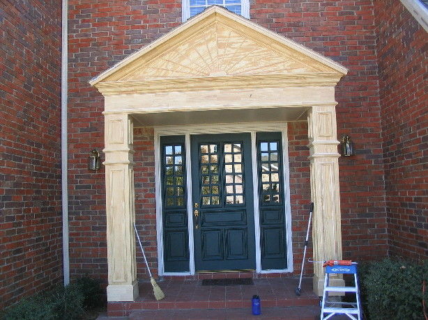

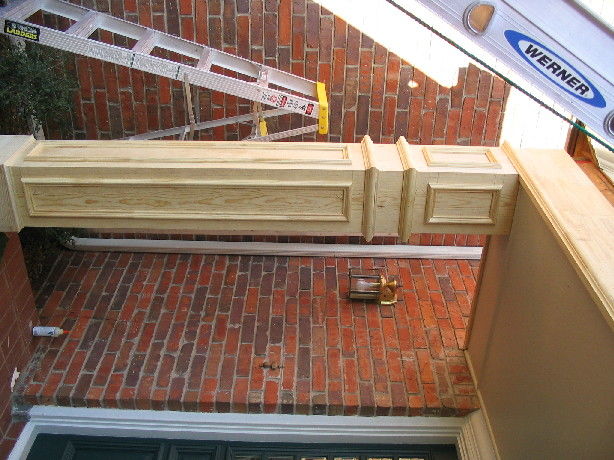

Here are pictures of a porch I rebuilt from the framing up. I built the colums with mitered 12″ pine boards. The trim is mostly finger jointed pine.

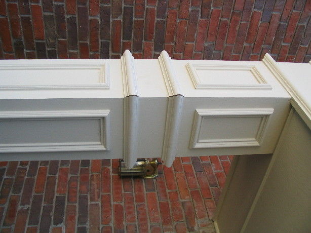

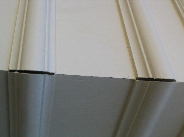

After only three months (I built it in November)the miters on the trim have all opened some as much as 3/16″. The miters were all glued as well. At first I thought that the trim shrunk, but that would mean it shrunk more than a 1/4″ over 12 inches! I don’t think that is possible. So now I think that the 12″ boards expanded. across the grain that seema more reasonable. So esentialy the columns are wider now than they were and the trim dosn’t fit.
So here is the question. Should I rebuild it? Or do I tell them that is the way wood is? Do I eat the repair?The original colum ws built with cedar boards, due to the cost diference I used Pine (after discussing it with the owners). I primed both sides with premium Bear exterior primer and topcoat. I thought that solid wood would be better than plywood, it certiantly cost more. I’ve been in business for 3 years and this was a good job for me as it generated a lot of interest in my work.

I am almost certin that the panels expanded. I dont think it is possible for those 12" pieces of door moulding to move that much, even if they were green. Like you said I back primed, but latex (and most oils) will not stop vapor transfer, just protect from wood rot. I feel like I did all the right things. Although cedar would be more rot resistant, it would expand and contract almost the same as pine. Even though I used inevpensive lumber I went the extra mile to build it to last using poly glue and back primeing everything. The only way I can think of to prevent this is to use plywood, but that will be more prone to rotting. Could I use PT plywood? Is that stuff paintable?

Can't see in the pics, but have the column boards cupped a bit as well? That would certainly add to the opening of those miters. I do think the boards themselves have swollen and changed dimension. That's pretty much a given.

I'd say it was about 50/50 the boards expanding and the trim shrinking, with a little bit of separation of the joints between the boards thrown in. This is what wood does, but, like the others said, you need to learn to compensate for it. Replacing the trim should fix it, and shouldn't break the bank on your end.
