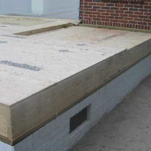

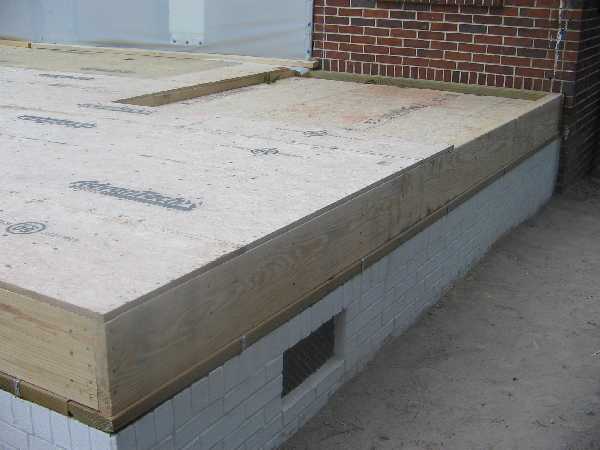

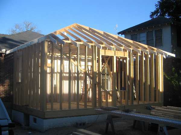

    I am build a small addition and will be using Kerdi for the first time. 6 x6 curbless shower.
     Reinforce the wall where the door will hang. Search this Forum for insulation question.
    What type of pan will you use?
    I am going with a mud floor. is end of day last Saturday.
    This is end of day yesterday?
