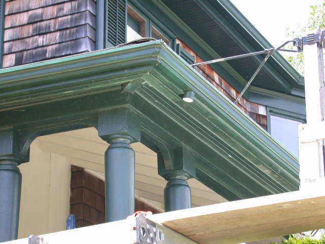

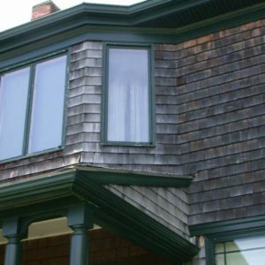

    here's an example of the third choice...we took this route because of the lower maintenance issue with aluminum gutters as opposed to wooden ..
    1. alancbrownm1 | Apr 05, 2003 06:28pm | #3
      dear Mike,
      Thanks for the nice response and photo. My molding detail and returns are really rotten.  what happens when I pull them off. Are they an integral part of the house framing? I should send you a photo. If I can figure out how to doit I will.

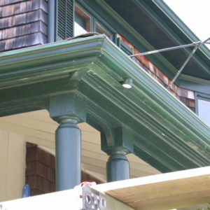

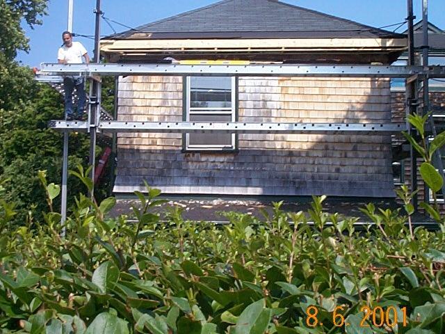

          6. xMikeSmith | Apr 06, 2003 05:26am | #29
            piffen .. al.. et al:
            this is a shingle victorian we worked on for two years.. after 50 years of patch and paste..
            rotted rafter tails, gutters, fascias & soffits... the roofing was relatively good so we chose to strip just the bottom three feet and work our way around the house.. here's the west wing..
            first thing we discovered was nothing was level , because the corner had dropped 6 inches.. fixed that and then onto the cornice.. new tails, new rewood soffit, new bed molding.. 6 inch aluminum gutter, and vinyl  soffits, everything backprimed and two coats of acrylic victorian green..

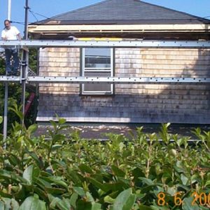

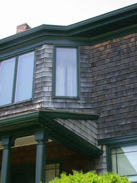

          7. xMikeSmith | Apr 06, 2003 05:28am | #30
            and on the front there is a funny bay dormer. same treatment..

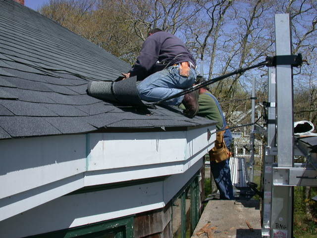

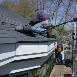

        1. xMikeSmith | Apr 05, 2003 08:17pm | #7
          my buddy , barry , ran a slate and gutter company in yonkers for years.. great copper man too.... oh, well.. now he's settled in Rhode Island.. you probably couldn't lure him back
          here's barry doing some of that gutter replacement...

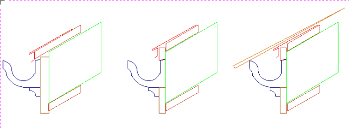

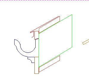

      4. Piffin | Apr 05, 2003 10:13pm | #10
        The attachment showsa a series of three gutter profiles for wood gutters.
        The first on left shows a more modern installation I have seen with the gutter applied over the facia in a retrofit fashion.
        The center one shows what is normally, in my experience, done in classical homes with the gutter installed directly to the framing. It is trimed above and below with the fascia and being open to air at the rafter tails on the back allows it to dry in that direction also. Sometimes dentil work is included with the under trim where the scsotia is drawn.
        The right detail shows how these old gutters often get covewred over with the next roof.
        Hope this helps..
        1. xMikeSmith | Apr 05, 2003 11:30pm | #11
          #3 seems like what they want to do to al's gutters.. at which point they would then hang a copper half-round on bar hangers..but this will change the cornice appearance...
          now.. if...
          if the gutters are superfluous ?????? then #3 would be a good choice, but if he still needs gutters ... hmmmmmmMike Smith   Rhode Island : Design / Build / Repair / Restore

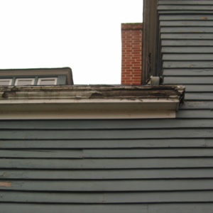

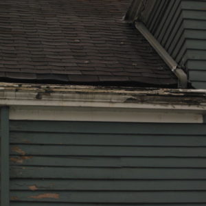

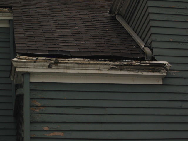

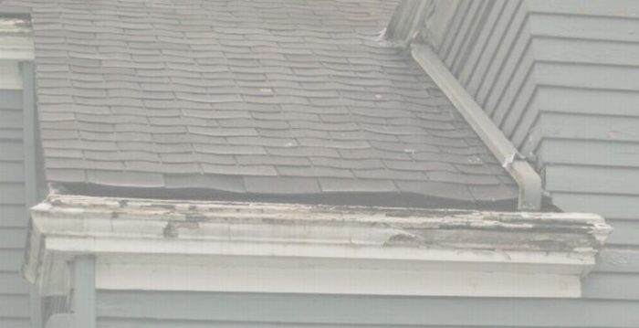

          1. alancbrownm1 | Apr 05, 2003 11:40pm | #12
            here is a picture of my gutters - finally. My file was too large so i photographed it again at a lower resolution.
            Alan

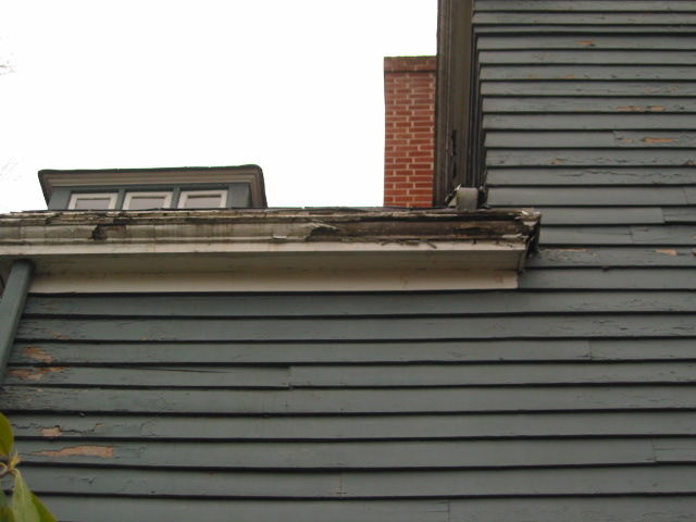

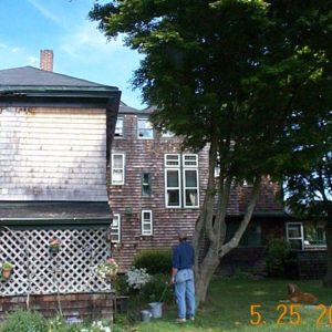

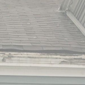

        2. alancbrownm1 | Apr 05, 2003 11:59pm | #15
          Thank you. You really have been helpful. Now all i need to do is find the right person to do the job in this area.
          Alan
          another picture

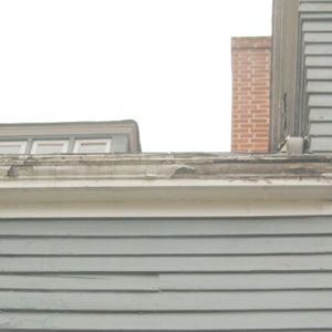

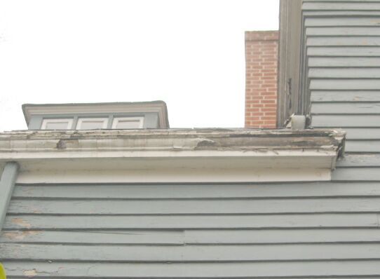

          1. Piffin | Apr 06, 2003 12:27am | #18
            At risk of overloadaing Prospero's photo files, I am reposting the photos reworked for clarity and light.
            As I see it, these may be 'Yankee gutters formed with molding profiles and other millwork instead of actual milled wood gutters. They may be part of the integral structure of the house and expensive to repair but I think I would recommend digging into it because the condition of your siding tells me that you have other moisture problems. I would be able to see more if these photos were from a more elevated vantage point. You do need a total home improvement or restoration person. This home needs a good friend..
          2. andybuildz | Apr 06, 2003 12:35am | #20
            Piff
                 HE needs maybe not JUST a roof and new gutter system by the pictures he's posted but possibly new roof sheathing. Looks like he has several layers of roofing on there for some reason....as in....the people before him tried covering up problems.
             The siding seems to be in need of stripping but my guess isnt as bad as the roof and gutter area.
            He better rip that entire roof before he deceides the route he's going to go with those gutters.

          3. Piffin | Apr 06, 2003 03:17am | #21
            Andy, he haas two or three threads going about this roof so I'm not sure which one it is in but he says that the reason for the subject coming up is that he has shakes and then two layers of asphalt.
            I was going to correct him and say that it must be cedar shingles and not shakes because no-one ever puts asphat shingles over shakes. That was until I saw how lumpy the roof is! Looks like someone screwed this place up good.
            The time for new sheathing was two roofs ago.
            Anyway the roofers he has found so far are suggesting just covering the 'gutter' over with sheathing since it has to be sheathed anyways and that has been the seed for this whole thread..

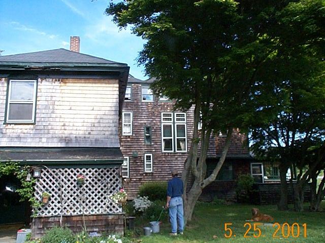

          4. xMikeSmith | Apr 06, 2003 04:23am | #22
            this is a budget problem.. if i was involved it would be a basic restoration... new siding, new flashings, new gutters, repoint the chinmneys.... and you saw the hodge-podge of leaders , right ?
            i would do some basic drawings with lots of "as-is " photos showing the trouble areas and the proposed fix.. my guess, it's a nose bleeder and it's too high for easy maintenance.. so i would incorporate a  lot of lowere maintenace features.. like FC claps for the wood we removed to install the new flashings
            al... if your equity can support it, and the value of the real estate is there, and you can afford it.. you are probably in line for some major restoration...
             if the real estate values won't support it , or your neighborhood is going south, or you can't afford the repairs..... then you probably want to simplify..
            how about some long range photos so we can see what you've got and what you want to preserve.. all the closeups do is show the problems.. i'd like to see what someone sees from the curb as they drive upMike Smith   Rhode Island : Design / Build / Repair / Restore

          8. andybuildz | Apr 06, 2003 04:56am | #27
            al
                Start with the roof.....gut it big time. Re sheath it if necessary which is my guess,,,gutters included.Reroof......then get back to us.
            Be covered
                        Namaste
                                   andy

          9. alancbrownm1 | Apr 06, 2003 05:03pm | #32
            Here are some long range photos and one photo from above like piffin wanted.
            Alan
    2. alancbrownm1 | Apr 05, 2003 11:52pm | #13
      dear Mike,
      I finally figured out how to send you a picture. My first file was too large. here goes.
      Alan
