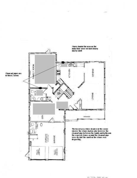

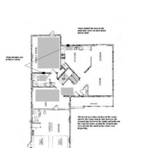

Also, the contractor finally after a year had a company come out to our house to take samples of air, dust.  They said the smell in the bathroom is stale air.  What are causes of stale air and how does it filter in to adjasent rooms (we have a venmar system and from what we can see it works fine).  The poblem is only on one side of the house (floor plans attached)

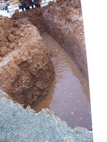

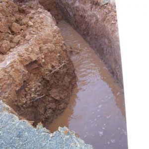

Another issue is we have slab on grade with frost wall.  There was no dainage tile installed around house.  I have attached a picture of the last hole cut in the frost wall to relieve the water under the slab.
The new home warranty representative is telling me that it is not required.  He said it is impossible to put around the house because it is to be put around the slab and where the slab is 6 – 8 inches above the ground.
His theroy is in a normal basement underground the drainage tile is installed around the floor slab.

    You've got pipes that were either never glued, coupled, soldered together or one or more has ruptured.

      Ill agree with Sam, you might have a vent pipe that is venting into a wall or attic instead of outside

        Debbie, have you had the drain pipe scoped?  I think sam t is suggesting you have a break underground.  If not the drain, does your copper run underground?  You have a health dept in that town?Remodeling Contractor just outside the Glass City.

          A little work for a plumber would involve pulling toilets and installing test plugs. Same thing for sink, tubs,washer stand pipe and showers. There should also be cleanouts for the main waste line that should be plugged, and then everything  wet tested, by filling the system with water through the vent stack.
          Around here that test is required to hold for 24 hrs with no drop in the water level. For her problem, I would guess she would see a significant drop in the level in a hour or two at the most.
          another test would be to "smoke bomb" the main waste line with all traps and fixtures in place. The smoke bomb is placed in the waste line down stream of the house, set off, and then the pipe sealed off. Smoke should only come out the vent stacks on the roof. Anyplace else, and the souce of the smell is there.
          It is going to cost a little up front  money to  adentify the problem, but that is better than throwing money at an unidentified one.

    I don't mean to be discouraging, but my first response about the contractor taking samples and saying it's "stale air" is "What the blank is "stale air"?" Talk about a no answer answer! I agree with what others proposed to test things. Seems to me it's also a cop-out when the guy tells you that drain tiles can't be put around the slab--put it at the bottom (but alongside, not under) the frost wall and run them level with that and put gravel over it so the gravel almost comes to the ground where slab is high. But I'm no foundation expert. Just seems like you're getting ...not exactly the whole story here.

    In my opinion that is a lot of ground water that you have around your house. Slabs on grade work fine if you have good drainage, in your case you have to establish that you have that,I think you should consult with a professional engineer.

        Now for the latest update.  We hired competant plumbers (not the builders)  The first thing so far that has been done is a scope into the drainage pipe.  Everything appears to be connected.  However they are starting to guess there could be a leak or may a joint not sealed.  They removed the toilet and discovered that the vent? in side the toilet may have been repaired.
        The toilet was left off and the hole sealed with a plug.  That musty earthy smell from the hole, is the smell in the bathroom.  They will be returning tomorrow to do other investigative work.
        They had instructed me to remove  anthing that had a smell like candles, soaps etc.  When I walked into the bathroom the smell was so bad.  I called them right away and so far I have placed and heavy plactic and tape around the hold where the toilet was.
