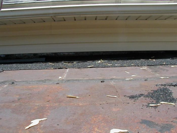

Checked on a job the other day and having difficulty downloading the camera pics so all I have to work with right now are words.
Over a porch entry a very low sloped 6 1/2 by 14 ft roof that at one time had rolled roofing covering it but know is for the most part curled and deteriorated away leaving the exposed metal panels.
Something like 1×2 ft tin panels sitting side by side making the roof. Apparently they didn’t nail down the rolled roofing as there are no nail holes evident but there are a few tiny rust holes forming toward the eve on one or two of the panels.
I’ve never dealt with this before and was wondering what my options might be. Wish i had the pics.

You got ya a terne flat seam roof there. If you can get the roll roofing off of it, Geocel products are what we use to restore something like this. Gimme some pix and I can be more helpful.

To me that looks so rusted up I wonder if it was just galvanized to begin with and no terne ??
Is that possible ? Not that it changes the receipe for restoration .

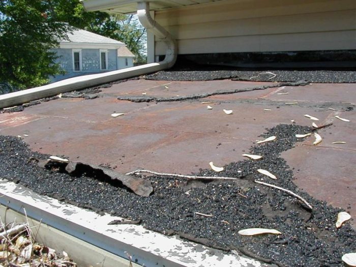

so - what is to be done at the 'butchered drip edge'? - looks like the weak point of the system - "there's enough for everyone"
I suspect that drip edge was installed with the roll roof and is applied over the original. My guess is that it can just be removed and tossed.http://www.quittintime.com/ View Image
waitawaitawaitawaitawaitawaita minute now.
Vinyl siding and gutters added later will compound the issue of dripedge removal.
Yer saying I can't leave the drip edge as is and just firm everything up?

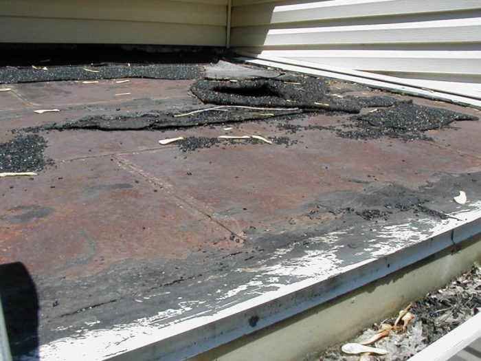

I don't know - can't tell from the pic. I've brought back terne that had a solid coat of rust on it - Hardly any sign of paint left.http://www.quittintime.com/ View Image

I told you not to get involved with that! - didn't I?- well, maybe not - but what you show doesn't surprise me - only one way out that I see - rip it off, replace the corruption, put a new surface down, flash - suppose you could cheap out and roll roof it - again - be good for 5-10 years - but I'm just a dumb farmer - I don't think you're going to paint anything on what's left of that roof that's going to last - "there's enough for everyone"

Is it just bad where they cut the box gutter off? I'm guessing that's what's taken place. Install new drip edge, pop rivet the old metal to the new drip edge. Get a roll of terne or a sheet of galvy and pop rivet some patches where the metal is rotten. Apply Geocel.http://www.quittintime.com/ View Image
ya, that's the worse on the corner there. One other spot about midway also by the eve.
So poprivet new drip edge on top of the terne and rivet a full length piece of galvy all the way down the length of eve
and rivet galvy over those other bad spots, 2300 any holes, coat with 2310 then top coat?

For rivit placement, you kinda have to feel it out for where the good metal underneath is, but about an inch and a half or two inches would be max.
