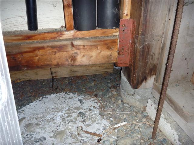

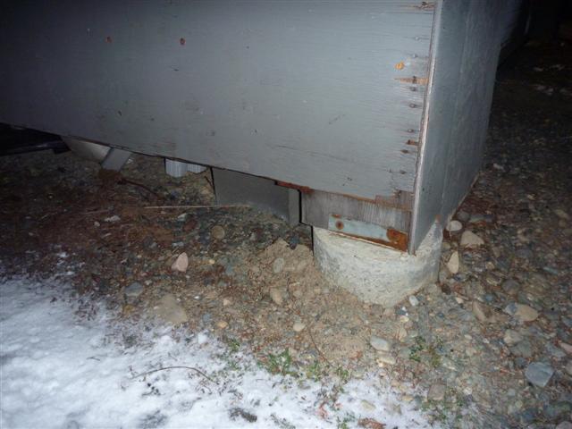

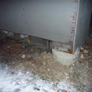

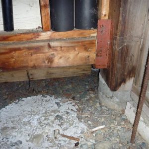

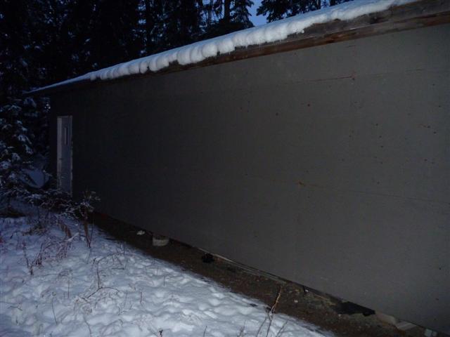

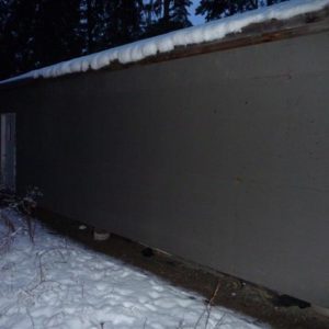

    1. longshanks73 | Dec 01, 2011 11:19am | #2
      added some photos
      here are some better photos of the structure.
        xxPaulCPxx | Dec 01, 2011 01:39pm | #4
        Much better!
        I think your first task is to VERIFY how sound this structure is before you invest any of your own time and labor on this.  A 6x18 GluLam will sting a little if it falls on your head.
        You should verify how deep these piers go, if they are below the frost line, and how big the bottom of the pad is.  From there, a local building engineer will tell you if it was built correctly or if it's a tragic YouTube video waiting to happen.
      2. calvin | Dec 01, 2011 07:47pm | #7
        long
        where is this 6x18 beam you speak of?
        The photo sure doesn't look like it.
  2. doormatt | Dec 01, 2011 01:06pm | #3
    Trying to understand your framing... Do the 6x18 glu-lam beams span span down each 30' side of the building?  Are they sitting directly over the concrete piers, with wall structure built directly on top?

    1. longshanks73 | Dec 02, 2011 11:45am | #8
      to answer all your questions:
      the sonotubes were poured below the frost line and apparently the bases are 3-4' in diameter.  The building hasn't moved an inch that I can tell.
      I think I did a poor job of estimating the sizes of the posts/beams.  The uprights (situated over the sonotubes) are all about 12" by 12".  All the beams spanning between the sonotubes are about 8" by 8", and then there are some huge beams, about 16" deep, along the top of the walls.  In between the beams the shed is framed with typical 24"OC 2x4 frame.  As I was saying - a dog's breakfast of different building materials but in my estimation the structure is quite solid.
