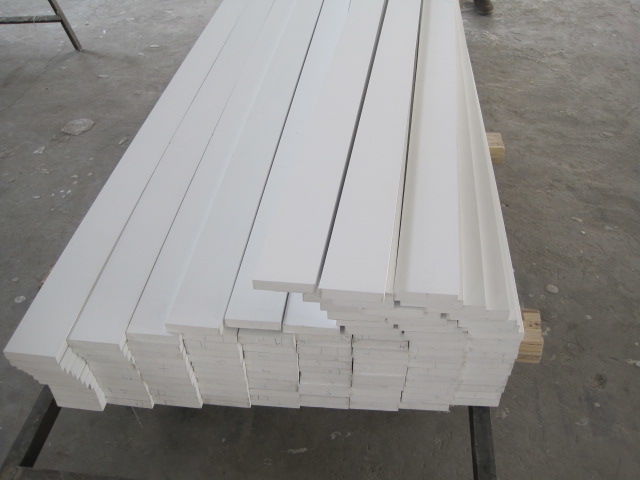

      Here in NW Oh, paulownia is offered as an exterior board-comes primed and is finger jointed.  Nice to work with, but there's been some talk on forums of it not holding up to the weather.
      Can you comment on your experiences?
      I see you claim it is naturally insect unfriendly and not susceptible to decay.  That seems to be in direct contradiction.

    Here in NW Oh, paulownia is offered as an exterior board-comes primed and is finger jointed.  Nice to work with, but there's been some talk on forums of it not holding up to the weather. Can you comment on your experiences?
    I understand why you have this question, paulownia wood is seen as a kind of soft wood lumber , however people usually see their physical weight but ignoring the natural super characteristics , in fact :
    First: Tests by the University of Southern Queensland of Western Red Cedar and Paulownia showed that Paulownia had better compression and shear qualities.  When this is coupled with the comparative density at 11% moisture of 275Kg/m3 for Paulownia and 450Kg/m3 for Western Red Cedar: Paulownia lighter but stronger, so the result is when put into the weather , paulownia is much more durable!
    Second: we need to see the paulownia wood’s cell structure , when the paulownia wood is dried , the wood cell becomes totally closed structure , just like some crowd of people are hands with hands together to fight their enemy (water, strength …) , thus paulownia is much more dimentionally stable in structure ---this results the paulownia is better when presenting into the weather ! no warping , no splitting …
    Third,  about the paulownia’s working properties: Gluing of paulownia wood :Gluing - Paulownia has been tested with five different brands of PVA, Cross-linked PVA and Urea Formaldehyde adhesives. Samples were prepared with each type of adhesive and Standard Separation tests conducted. Manufacturers recommendations were observed for each adhesive. 100% of the tested samples passed i.e. they did not separate along the glue line. AlI gave excellent results with minimal clamping time. Comparative tests between Paulownia and other hardwoods all showed the superiority of Paulownia timber with respect to fast cure time and uniform glue time. In all cases, using PVA adhesives on Paulownia halved the average time required for clamping. The time and cost saving in a board jointing production run is obvious.
    ---that is to say , paulownia’s gluing working property is super !
    Fourth : I noted your address in OHIO , we are selling a lot there ! probably what you seen the paulownia trim boards are made from our company :D ! we are using bi-component exterior water-proof glue ! to be used in the exterior environment has none problem !
    Fifth: it is same important if the manufacturer is using water-proof painting for the trim boards also ! we are making with exterior water-proof painting , with good adhesiving to the paulownia wood , which makes the paulownia trim boards very much suitable to the weather !
        All in all, paulownia trim boards are very much good when they are holding up to weather !
