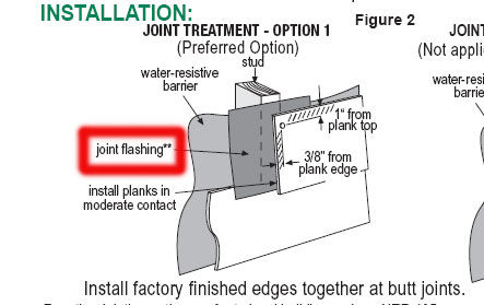

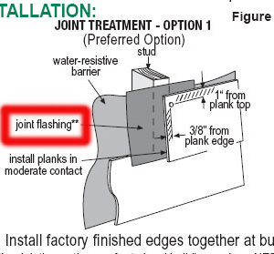

Ok, so I checked the Hardi site and see the attached excerpt (which must be new). I think this is my best option.Thanks for the ideas.Scott.Always remember those first immortal words that Adam said to Eve, “You’d better stand back, I don’t know how big this thing’s going to get.”
That's been there as long as I remember. (Which ain't all that long any more, I'll admit!) I usually just use scrap coil stock. Others use tar paper.
Mike HennessyPittsburgh, PA
