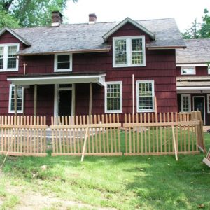

    Here's a few more...
    and yeh...1x4 clear red cedar rails both sides top and bottom. Pyramided the tops of the clear red cedar 2x2's after cut to size in the template I made. Stained with BM oil problem solver top coated with BM latex solid white stain, Store bought tops w/copper.sick of fences sick of fences sick of fences sick of fences sick of fences sick of fences sick of fences sick of fences sick of fences sick of fences sick of fences sick of fences sick of fences sick of fences sick of fences sick of fences sick of fences sick of fences sick of fences sick of fences sick of fences sick of fences sick of fences sick of fences sick of fences sick of fences sick of fences sick of fences sick of fences sick of fences sick of fences sick of fences sick of fences sick of fences sick of fences sick of fences sick of fences sick of fences sick of fences sick of fences sick of fences sick of fences sick of fences sick of fences sick of fences sick of fences sick of fences sick of fences sick of fences sick of fences sick of fences sick of fences sick of fences sick of fences sick of fences sick of fences sick of fences sick of fences sick of fences sick of fences sick of fences sick of fences sick of fences sick of fences

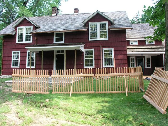

  4. andybuildz | Oct 20, 2006 04:59am | #4
    See the three stacks of pickets. I'll have more than one whole stack left to sell. Clear red cedar approx 48" 2x2. At cost!
    Did I say I'm sick of making fences? LOL
