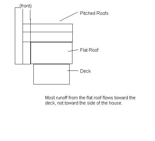

Sorry, my digital camera was stolen about a year ago. Here's a line drawing from an overhead view.
Thanks again for the help.
we need elevations. Roof heights to the deck/ground and roof to roofs.

Ground-to-deck is 2 feet (approx).
Ground to flat roof is about 11-1/2 feet
Flat roof to peaks is probably 8 feet, though I didn't measure it.
My only thought would be to use the corrugated plexi transparent roofs that come in several colors.
Some think it looks tacky but I think you could make a design with the stuff to make it more attractive then the way that some people have used it in the past......Short of that I suppose you could continue the flat roof with built up skylight boxes but youre probably talking about seven feet or less at the eave for headroom.

Extending the flat roof might not look very good, and you could run out of headroom keeping the pitch going. Any sort of roof lower than the existing flat roof is going to be tough in terms of headroom, and little light will come in from the low edges.
If you wanted to build a nice pitched roof higher than the existing flat roof(with gable end facing flat roof), you could build pitched 'diverters' to redirect the water away from the new sidewall (to the sides of the flat roof). Struggling to explain, these would be similar to a very large chimney cricket. I've seen this before. I've also seen this problem solved with a simpler 'curb' design to redirect the water, which may be adequate without snow.
With the higher roof, and some skylights, it would be a bright space.
Actually, now that I imagine this, a hip roof might look better
