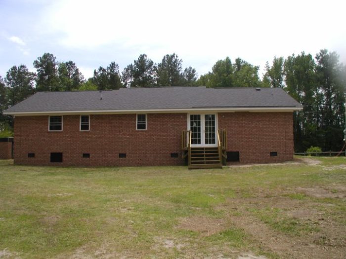

Well, this remodel just seems to go on and on. I was starting to rough-in the ductwork for my heat pump when the DW decides that we really need one more window (never mind that we just finished re-bricking the house). Looking at the photo, you’ll see some temporary steps. But the ultimate plan is to construct a nice deck and gazebo off the rear. With that in mind, my wife wants to add another window to the right of the patio doors, about 4-5 feet from the corner. The window would be the same size as the one on the far left (3-0/3-2).
Anyway, I’ve still got sand, brick, etc. to do this and I’m confident that I can create the rough opening, though not looking forward to it. The interior is still in the rough stage, so the plan is to frame the RO from within and then use the corners of the opening to drill reference holes to the outside of the brick veneer, followed by some chalk lines and careful cutting with a masonry blade. Of course, I’ll have to bring the mason back to patch things up after the window goes in.
Have you guys ever tackled a window installation like this? Any suggestions?

That's a no brainer for the mason, though he may be about as thrilled as you are. Toughest part I believe is getting a lintel in at the top of the opening.

"Toughest part I believe is getting a lintel in at the top of the opening."
Fortunately, the overhang begins immediately above the window, so no lintels were needed here.New knowledge is priceless.

Well, at least since your brick is new you can match the brick and mortar exactly.

Check with in the brick dimension to ? Aline with the joint of every other one on the vertical so you don't have a bunch of 1/4" slivers of brick. Get close from inside and then adjust from the outside in.
