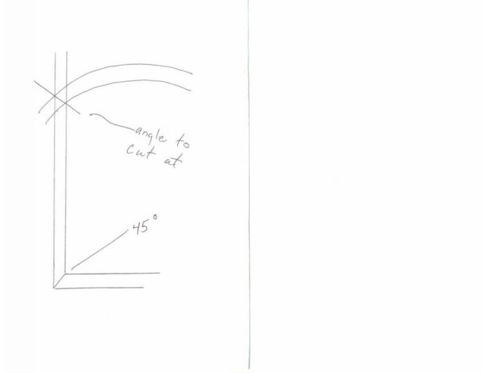

  2. DougU | Aug 04, 2005 04:56am | #2
    Frank
    I do a picture better then I do words. Look at the attachment.

    1. FrankR | Aug 04, 2005 05:34am | #3
      Thanks for the visual.  The arch molding is flexible and was made to fit this opening.  I'll definitely measure twice on that cut.
      Frank R.
      1. DougU | Aug 04, 2005 05:59am | #5
        Frank
        Dont measure, hold it up there and mark it, less chance of a mistake.
        When your making the money cut you cant have any mistakes!
