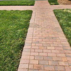

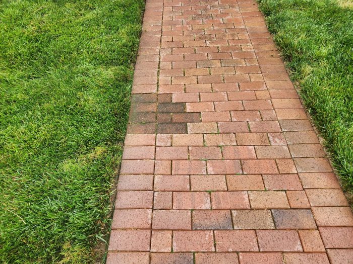

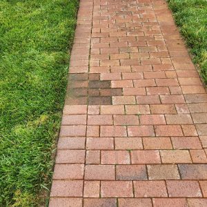

Attached is a photo of my front walk way.  When it rains it looks like the photo.
What’s going on?  It’s clear that was a patch job at some point.
Thanks,
Bob (Homeowner, Charlotte NC)

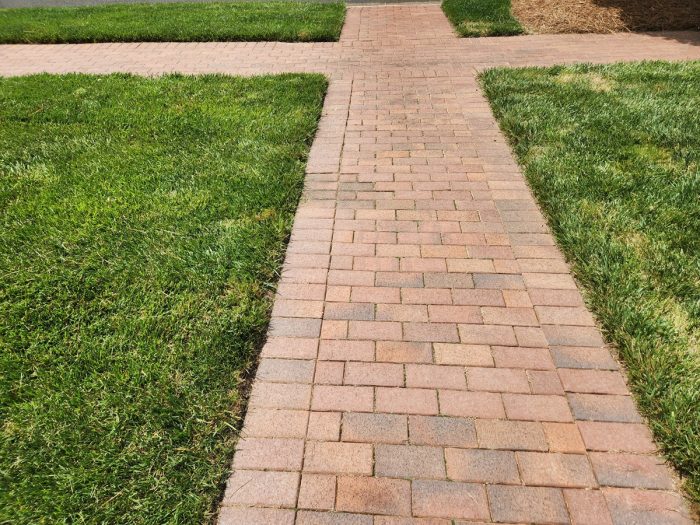

    Post a pic when dry.
  2. user-5449330 | Apr 25, 2025 12:55pm | #2
    Dry
    ct_yankee | Apr 26, 2025 08:15am | #3
    Simple. While the patch (if it was a patch) used bricks of a different composition than the rest of the walk. So when wet they appear darker.
    The fix would be to find bricks matching the bulk of the walk and replace those the appear darker when wet.
    1. designbing | Apr 26, 2025 11:07am | #4
      You know it's not easy if the original walkway is 10-20 years old.
        ct_yankee | Apr 26, 2025 01:02pm | #5
        Exactly. Even if sourcing replacement bricks from the same producer. Raw materials vary over time resulting in variations in appearance.
