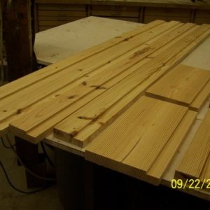

Here was my construction technique – I started with HD 2x SYP, construction wood, and last night I went and chose the very straightest ones – less than $30 worth.

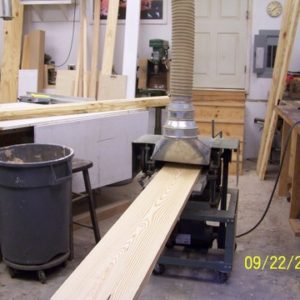

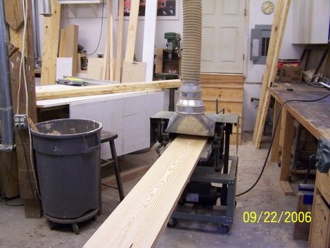

Planed to 1-3/8″ – just a 1/16″ pass on each side.

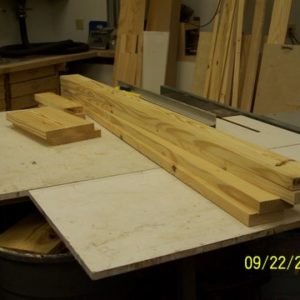

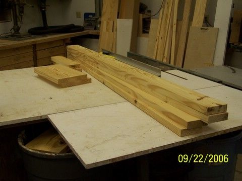

(8) pieces cut to length and ripped to width. Flipped back and forth ripping to get the normal developing curve out; kinda’ using TS as a jointer – that’s why I started with 2x8s for a 4-1/2″ rail. (4) horizontal members are 3″ longer than needed, to accommodate the corner joints.

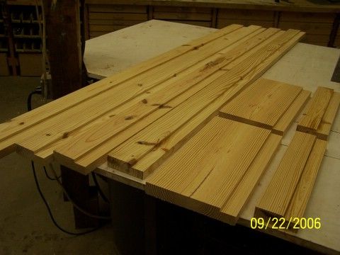

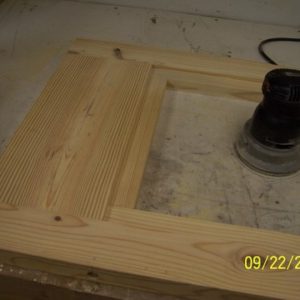

All have an identical 1-1/2″ x 3/8″ rabbet

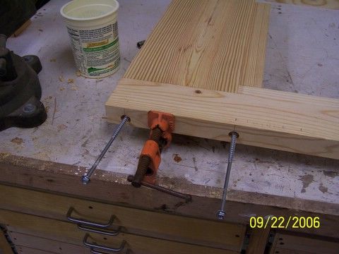

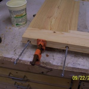

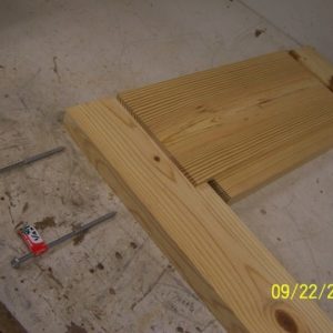

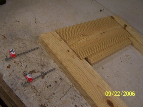

Cut the reverse of the rabbit on the horizontal members; 1″ x 1-1/2″. I use 1/4″ x 6″ Spax screws; heads recessed; predrilled through.
Quick clamp and bolt together – holes will be Bondo-ed. Joinery as simple and accurate enough that the frames pretty much self-square.

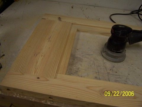

Tiny touch-up the corners – this is the outside, where the ScreenTrack will be mounted after paint.
Viola! Immediately ready to cut hinge mortises, sink ball detent hole in top, and prime. Same pattern as the exterior doors, and they feel really heavy and substantial. They’ll get nice brass hinges, dummy knobs, and the ball detents at the top.

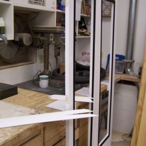

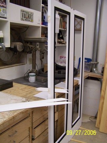

Here are the doors; primed and with the the black Screen Track base strip installed on the outside face.

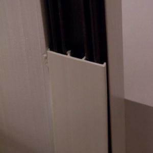

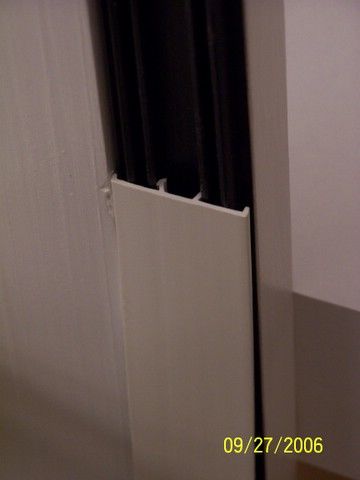

Close up of Screen Track; I snapped on a piece of the white cover strip for the photo - the screen would normally be splined in the right-most groove in the black base.

Door insides competed. Brass dummy knobs; ball detents up top
The door on the left shows the front (inside the house), the one on the right shows the outside face and the assembled Screen Track - pretty near invisible.
