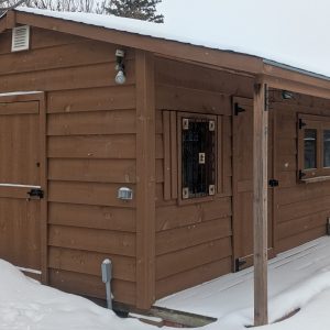

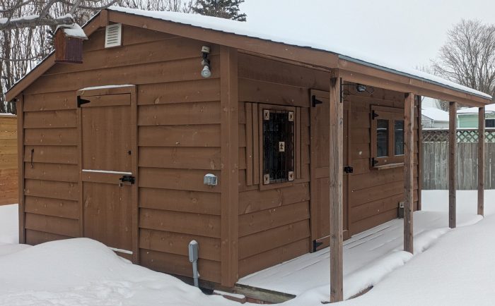

Shed is conventionally framed, 2X4's 16" OC. Roof is not trussed but stick framed. Clad with wood siding. Porch is integral with shed.
Given location of shed in yard, it would be difficult to access with a crane.
I have included a picture.

Dimensions provided do not include porch, which extends an additional 30 ", the entire length of shed.

The porch floor is shared with the rest of the structure.
From what I can ascertain, the shed is sitting on 2X2 patio slabs.
