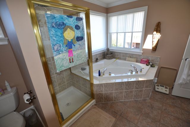

Client wants me to replace jet tub with regular tub.  I think the drain will need to be relocated.  Apparently there is radiant flooring heating.  Not sure if it is pex incased in concrete.
Any ideas?

    First: what is regular tub? Assuming 60" long x 32" wide.
    The corner tub looks like it is 60" on both long sides under the windows. Judging by the showerpan, the short legs seem to be about 32/34". Very seldom is radiant  heating installed under the tub.   My suggestion would be to remove the whirlpool tub and support walls. This will expose the drain. Locate the new drain and drill/grind the concrete (if there is any) carefully in small increments to avoid hitting a possible waterline. I would not be surprised if you just find wood subfloor under the tub.
    What will the new floor look like? Do you have enough tiles to finish to the new tub? If not you could create a new "floor mat"
    The same would apply if you have electrical radiant floor heating
