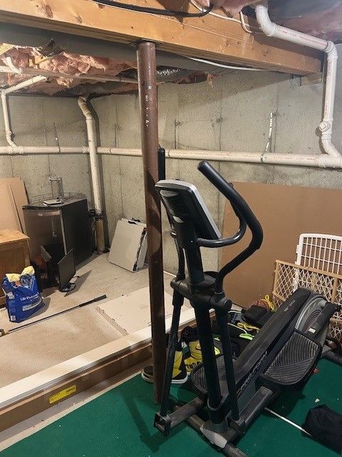

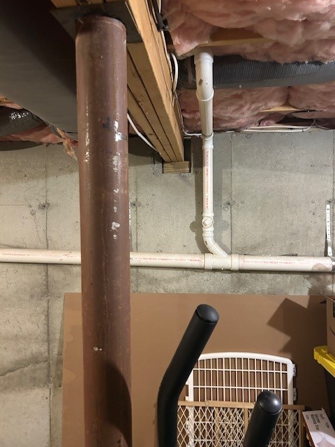

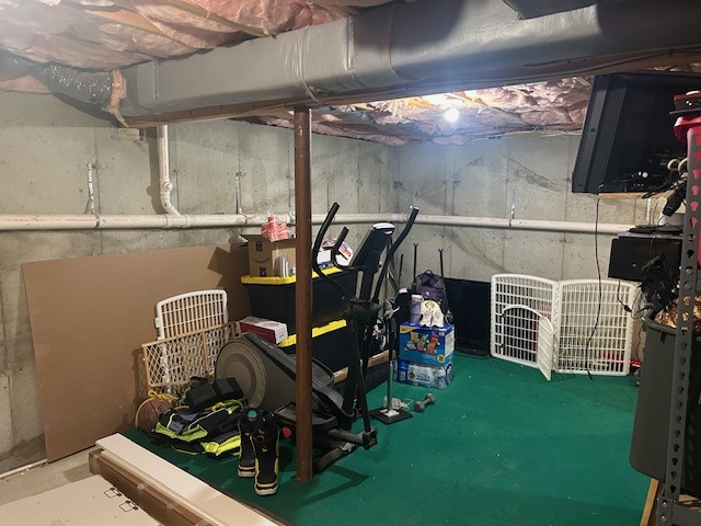

Hi there! I am in the process of finishing my basement (2 story colonial). I have a column on a load bearing beam I would like to remove, but I’m not 100% on the best way to re-enforce the load. The beam span is 12′ long and there is currently 3x – 2×10’s with one end of the beam siting in the notch in the foundation and the other end on a different column. I have an additional column that is 6′ in that I would like to remove. I know the proper way would be to remove the 2×10’s and replace it with 3 2×10 LVL’s. However, I’m wondering if I could get by with sistering an LVL on each side of the existing beam and then removing the column? I will be framing a wall against the foundation which will also be extra added support under each side of the beam. I will upload pictures of what I currently have.

Where did you get the idea that three 2x10 LVL would do the job for the full span?
Remember that this beam needs to be installed so that loads at support points are carried to the foundation. Depending on the details, your concrete slab floor may not be up to the task.
Why not build a pair of temporary walls on either side of the existing beam, and install the proper support?
You should be able to reuse the materials used in your temporary walls as you refinish the basement.
