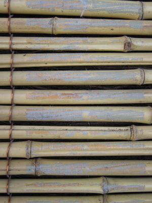

I used some duct tape to hold this bamboo in place temporarily, well, I left it on for over two years, sitting under my house in the basement. Would anyone know of a good way to remove it now ?
"Goof Off " and elbow grease should work. Be careful that it doesn't take any finish off the bamboo.

This and elbow grease. Find it at automotive paint stores.

I've had people tell me that there is a GOOP product that works too. Probably at the big box stores.

Mayonaisse, or WD-40.

Mayonnaise.Had a guy tell me once that if you ever had an old iron pot or skillet that was so crusty black you couldn't clean it to soak it a while with mayo and it would clean'er up spic n span clean.

Yup. It is an emulsion of water and oil ( fat from yolks, and veggie oil)...had some tuna salad clean my hands of caulk one day..so I tried it on other stuff. It works. Spheramid Enterprises Architectural Woodworks

mineral spirits...
it's kinder but more elbow grease...
goof off will change the color of the bamboo...
Napalm!!
But it may change the color of the bamboo....

I'd think Goo Gone would work.
