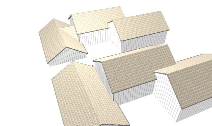

As to the garage intersection, I'm not sure that I understand. It sounds like the garge was added after the house was finished and just planted there without tying them together properly so that you ended up with a dead valley. There should be a cricket framed there to divert water before shingling if Iunjderstand the scenario correctly.

In this sketchup, there is a dead valley nearest the camera similar to what I believe you have described. Dead valleys are anathema to roofers as dead air is to radio personalities.
The copy further back hasa cricket added to that intersection to divert water..
Piff, the way I read your sketch, the dead valley is where the downslope meets the sidewall, and the cricket elimates that problem. Is a dead valley also the intersection of the two roofs on the right side of the house? How do you address that?

You are right.
My method to adress that is to never design with a dead valley. Occasionally, I would find myself roofing townhouses with offsets that created something similar, by the distance of the roof overhang times two - generally pnly about two feet. I roofed those with a plentious 30# felt underlayment lapped over the lower shingles, a twenty inch wide valley metal, cut shingles for a four inch open metal, and plenty of sealant, topped off by a prayer.
For buildings overlapping as drawn for the example, a double ended cricket would be necessary, one wing intersecting each opposing roof to create real downsloping valleys..
