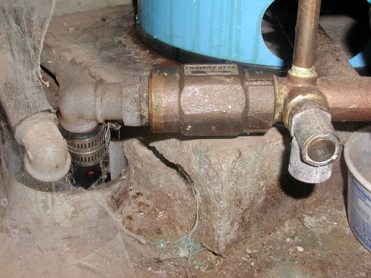

      So, just cut the pipe going to the tank and don't mess with the tee at all, except to add the union?  Pretty simple repair, except that I don't think I have the room between the pipe and the platform to cut the pipe all the way around with a pipe cutter.   Mooney made the comment , "My number one complaint with plumbers other than seeing one with a sawsall."    Since, if I can't get a pipe cutter around the pipe, I'll probably pull out the sawsall to make the cut, what's wrong with using a sawsall?

          I don't think you want to make a cut between the tank and the tee. That should be a cast bronze fitting, not a piece of copper pipe, going all the way in to the fitting on the bottom of the tank. If so, its OD is going to be too big to fit inside a copper fitting. See this web page - http://www.aymcdonald.com/ProdList_Plumbing.cfm?getgroup=49&sendCat=11What I think you have is similar to #2045. If you want a union to make it any easier to install another tank later, replace the existing tank tee with #2047.

        It's hard to be sure from your photo, but to me it looks like a bronze T with ¾" copper tubing running back to the tank. That's a fairly typical configuration. Here's a photo of a similar installation.

          I took a closer look and the tee is completely brass so I guess I have some disassembly to do.  On the left side it looks like I can remove the well supply line from the check valve.  On the right, desolder the line from the elbow and then I can lift out teh tank and tee, unscrew the entire tee assembly from the tank and put it on the new one.   Should anything on the tee be replaced or can I just reuse everything?
          The vertical line coming out of the right elbow connects to another 90 degree elbow for the line going to the sediment filter.    Since I put a shutoff on the inlet side of the filter when I injstalled it,  I may use that to shut the line off and move it over a bit so I can put a union on next to that lower elbow.

            From the close up photos you posted, it looks like you're going to have to do some cutting. But you may be able to salvage the T anyway.
            The gizmo on the well side of the T looks like a check-valve; assuming your pump is down the well (ie: 'pushing' the water up to that point) you don't have to worry about losing prime if you remove it. Unscrew the hose clamps on the PVC elbow, heat up the black hose a bit with a torch (go gently, you want to soften it, not melt it), and pull the fitting out of the hose.
            Now go to the house side of the tank. Cut the ½" tubing at least one inch above the elbow where you can get a clean shot at it. Now your tank, tee, and all are free to pull out of there except for the electrical connection on the pump control switch (kill the power and disconnect it. Tag the wires so you know which terminals they go to later). Once you get it free, lay the tank on its side and unscrew the T from the tank inlet.
            Clean up the tube ends where you had to cut, and sweat half a union on each end. If you really want to, you can now unscrew the PVC elbow from the check valve and add in a threaded union between them to avoid having to horse around with pulling the elbow next time.
            Clean up all the threads carefully and wrap new Teflon¯ tape on them (yes, even the pvc threads (but not the insert barbs)). Assemble, tighten, and test. If a threaded joint leaks, tighten it carefully till it does not. If a sweated joint leaks, drain the system and try it again. (You're allowed to curse, but not for over 20 seconds....)
            Be prepared for the fact you're going to get filthy dirty water in your lines for five minutes of so. Run the cold until it goes clear. Don't open any hot faucets until that happens or you'll push crud into the HW tank. If flow at sinks, showerheads etc. is below normal, check the screens & flow restrictor discs; a small bit of crud stuck in one of them can knock output way down.
