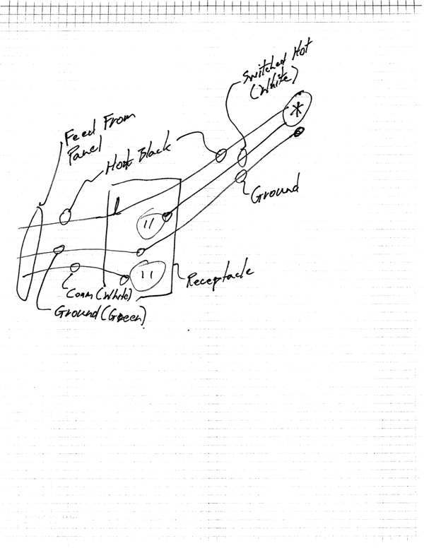

I have a wall outlet wired for a switch that runs a fan. The line coming into the box brings the hot wire from a receptacle outlet. Then a line runs from the receptacle to the fan bringing the neutral, the hot and the ground wire. So in the switch box there is only a hot(black) wire and a ground(the white wire is used to bring the power back to the receptacle from the switch).
I need to hook up a timer switch, which has a red and blck wire to handle the power thru the switch, a neutral(white) wire and a ground. IS IT SAFE TO HOOK THE WHITE NEUTRAL WIRE FROM THE TIMER TO THE GROUND WIRE IN THE BOX?

Can you post a picture or a sketch of the wiring?

Is this what you have?
If so, you just need to wire nut the white lead from the timer switch so there isn't a bare end. You also need to tape, or shrink wrap the white wire at both ends with either red or black, so that everyone knows that it is not the nuetral.
That won't work...
The timer he has requires a neutral.
