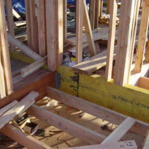

            jim...  i know you know this..
            but just to state the obvious:
            a general rule -of-thumb would be  if you are heading off a joist, then  the header is going to transfer the load of the headed joist to the side joists of the opening.. so , theoretically they are now carrying additional load so they must be doubled
            the more joists  headed, the more load transferred to the side,  the doubles become triples or beams
            the header itself , especially with a single headed joist, can usually be a single...
            but it is often penny wise and pound foolish  to run the risk that the Building Inspector  will make you reframe it.. so any labor  or material you originally  saved will be flushed down the toilet
            when in doubt, or lacking a PE stamp on the drawings, double , double, double..Mike Smith Rhode Island : Design / Build / Repair / Restore
          53. Framer | Feb 18, 2006 04:08pm | #110
            "the header itself , especially with a single headed joist, can usually be a single"Mike,The only time I've ever framed something like that was when the existing joists were 3x10's and that was once which was this past summer and there was a cneter girder about 4' away from the header.Are you saying unless otherwise noted on remodeling that you can frame cutting out one 16" center joist and head it off with a 30-1/2" head the 30-1/2" header can be a single and the joists on each side of it don't have to be doubled for 2x framing?If so around here that would never fly. Around here they now make us double up the headers for attic stairs and hvac returns and put hangers on them. Every skylight rafters and headers are always doubled. The only time you don't have to double up the skylight header is when the header that's closest to the wall is less then 12".Joe Carola

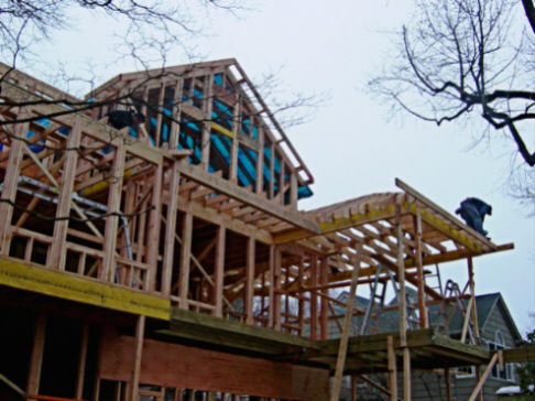

            i've seen the  framing specs get  more and more to the verge of overkill..
            so  i can sympathize with your  almost crying architect  .. whadda ya wanna bet the 2x10 hips were just fine.. but some PE  decided to CHA... ?
            look at what's happening to cantilever design Mike Smith Rhode Island : Design / Build / Repair / Restore

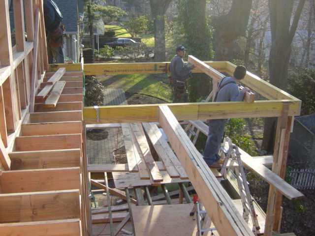

          57. Framer | Feb 18, 2006 05:14pm | #114
            "whadda ya wanna bet the 2x10 hips were just fine.. but some PE decided to CHA... ?"Mike,As far as I'm concerned they were fine because I've framed a million houses and additions that way. That house is the same basic two story colonial with 2x8 rafters and 2x10 hips that we've framed many many times before and all of a sudden this plan shows up with double 11-7/8" microlams. This guy couldn't convince me to waste that kind of material and money in a million years but I had to do it."look at what's happening to cantilever design"Are you talking about 2x framing or I-joist framing? What are they doing different from where your from?Joe Carola
            Edited 2/18/2006 9:23 am ET by Framer
          58. MikeSmith | Feb 18, 2006 07:40pm | #117
            joe.. remember the  raised ranches of 1970 ?  24' foundation with  a 28' 2d floor ?
             they were getting  2' cantilever on the 2x floor joists.... ok , they were wrong..
             but now.. if i move a bearing  wall off the wall below in the joist direction.. all of a sudden i've changed all of the loading.. to me  .. as long as i've stayed within the dimension of the joist ( for instance  moving a dormer wall in 12" on a 2x12 joist system, i should get full, or practically full,  value as the direct bearing..
            obviously there has to be some devaluing... but not enough to change the floor frame if the shed dormer wall is only supporting a roof ..
            but the plans come thru with lots of additional  requirements if you move off the wall belowMike Smith Rhode Island : Design / Build / Repair / Restore

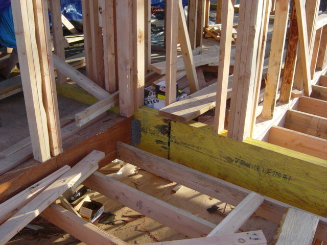

          59. Framer | Feb 18, 2006 08:26pm | #118
            "but now.. if i move a bearing wall off the wall below in the joist direction.. all of a sudden i've changed all of the loading.. to me .. as long as i've stayed within the dimension of the joist ( for instance moving a dormer wall in 12" on a 2x12 joist system, i should get full, or practically full, value as the direct bearing.."Mike,I just framed one like that about 3 weeks ago. The third floor was stepped in 16" though on top of 2x10's @16" centers and we had to put solid blocking under the wall. The wall above was a gable.You'll see picture #3 the gable at the top.

            i wonder what the solid blocking was doing ? think it takes the place of the rim joist ?
            of course in value engineering framing , they eliminate the rim joist anyways
            who can say...  a lot of CYA  going on  probablyMike Smith Rhode Island : Design / Build / Repair / Restore
          61. Framer | Feb 18, 2006 08:41pm | #120
            Mike,From the wall at the end of those 2x10's going out to those triple 2x10's were ciling joist and on top of those triples and the other micro's in the background was a wrap around roof. You can see in this picture.Joe Carola
