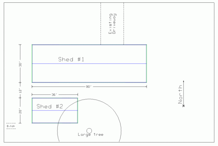

I attached a GIF with the rough dimensions of the buildings and such, just to give an idea of what’s going on.
That’s about all I know at this point. I’m curious if any of you have been through something like this.

Just got this sketch emailed to me. The utiliy gave this to the President of the club to show roughly where they want to remove soil.
Obviously, our larger building will have to go. They were talking like they might save part of it. But I don't see how that could be possible. If they take out one entire wall, there won't be much left.
