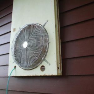

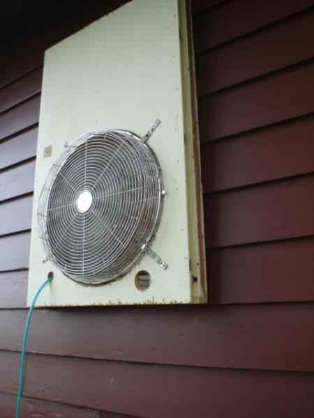

    I have successfully skimmed walls like you describe with USG "all purpose" (also LeFarge "all purpose"). It's a lot of work, but a fan system we came up with made it a lot easier (see attachment). Of course this depends on several factors (time of year, air intake, etc).
    With this fan hooked over the window we were able to use the random orbital sanders with 220 - without dust going into the house. Not to insult you but figure on 3 coats and use a bare bulb with the last.

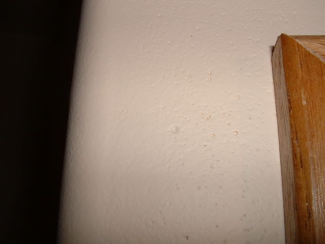

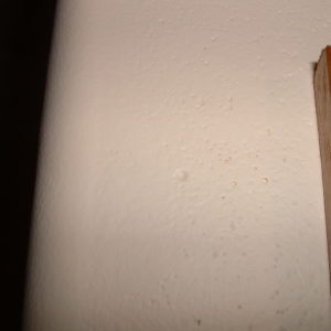

    We have had some problems with "hot spots" (chemical reaction discussed on this forum several times that causes gas bubbles). For filling these after wall is otherwise finished and primed with "USG First Coat" (or equivalent):
    Using a good silicone-latex caulk, damp sponge, and a 2 1/2 inch flex knife: swipe a 6 x 6 in area with the damp sponge. Fill and totally strike off caulk with the knife.
    (The swipe with the damp sponge allows a complete strike off of any caulk that is on the surface - since sanding the caulk doesn't work.)
      What causes them?  I don't recall reading about it here, but if you could point me to a thread (or subject), I would apreciate it.

        DonCanDo,I will give it a try on the "hot spots"- that's been over 2 years ago we had a discussion and they were bringing in previous discussions. I haven't always had good luck with prospero searches. What I am referring to as "hot spots" is anything that ends up as little craters - it looks like a bad case of healed acne. I understood from the discussion we had (back then) that there were several things that could cause the symptom (little craters). Anything that could cause gas as a reaction would be one possible cause (different ph of materials mined and used for plaster).Air in the mix from "overly vigorous mixing" was another possibility given - I got this from calling USG.Another bet was a reaction to residue from aluminum oxide from sandpaper.I'm sending a pic of it.Fz
        1. DonCanDo | Jun 09, 2006 04:13am | #26
          Ah, yes.  I've seen that before and even made a few myself.  In my case, I think I created them by using too much water when sponging off the joint compound.  I rarely wet sand anymore (except maybe in a closet in the basement) and when I do, it's with a fairly dry rag.
