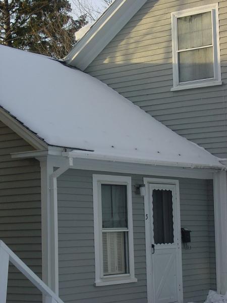

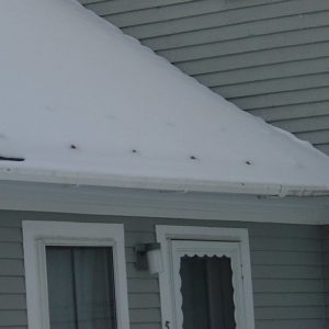

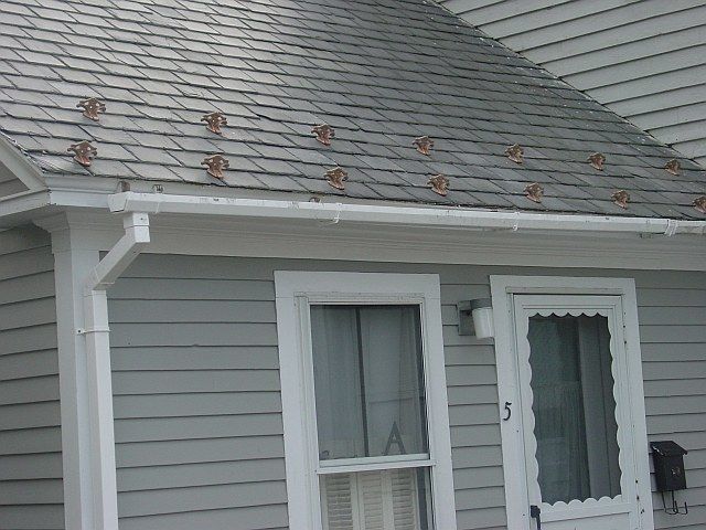

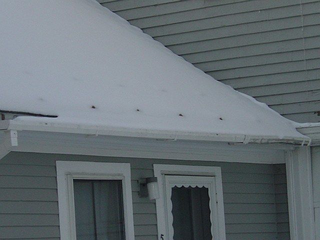

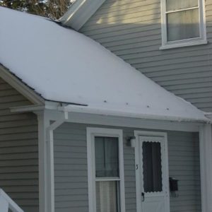

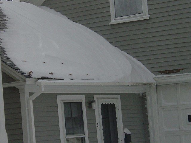

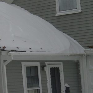

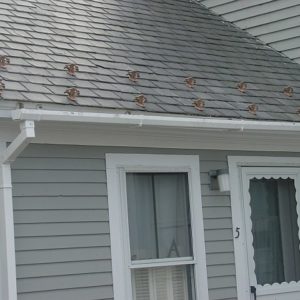

Just put these snow guards in last week to keep snow from cascading down onto the lady who lives in this apartment , and her vehicle.
We’ve had 2 snowstorms since – a 6″ fall late last week and 15″ of heavily wind driven snow last nite.
The wind has blown a lot off the rake , but the rest is holding solidly.
And no I played no role in the plastic gutter.

        It's ok, even WITH the snowbirds those gutters won't make but a few seasons.
        Then they can call you to do the job that should have been done first time around.The best reward for a job well done is the opportunity to do another.
        1. theslateman | Dec 23, 2008 04:31pm | #11
          David,

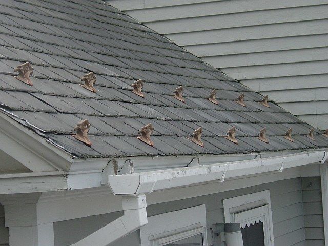

          Some of the parts still had the bar code sticker on them. So I agree , they won't last too long , although they're set above the roof plane in places so now they won't get sheared off with cascading snow and ice.

            Jeff_Clarke | Dec 24, 2008 05:22am | #22
            Walter - what's the procedure for post-installation?  Slate ripper to pull two courses?Jeff
          5. theslateman | Dec 24, 2008 01:19pm | #23
            Jeff,
            I didn't take any install photos this time , but normally I take out 3 slates on the diagonal to allow the guard to be nailed to the deck , then re install the slates.
            I'll look back in another thread to find that sequence for the install.
            Walter
          6. theslateman | Dec 24, 2008 02:10pm | #25
            Jeff,
            Here's an album showing the procedure for install into an existing slate roof.
            Walter
            http://share.shutterfly.com/action/welcome?sid=8cbsmrhq1zY
          7. woodarama | Dec 24, 2008 02:42pm | #26
            how do you secure that slate tile that you took out?
          8. theslateman | Dec 24, 2008 02:47pm | #27
            I've actually taken out three to install the snow guard  -the one thats cut to accept the copper bar stock and two above that.
            The cut slate is held at the butt with a slate hook and a nail in the open side. The next slate is double nailed on the open side , and the last one is held with just a slate hook.
