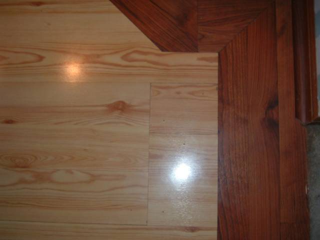

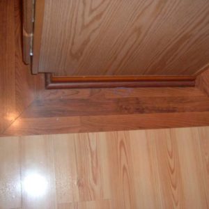

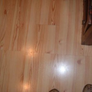

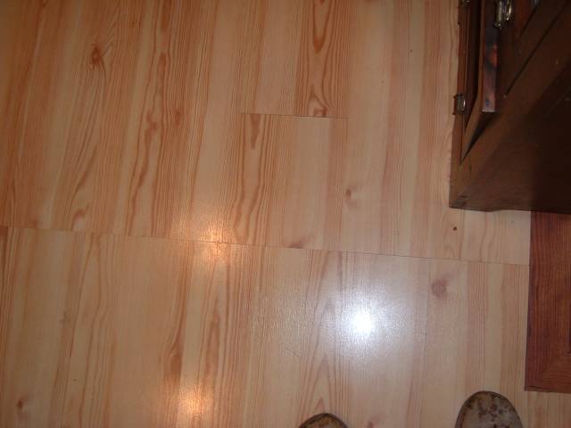

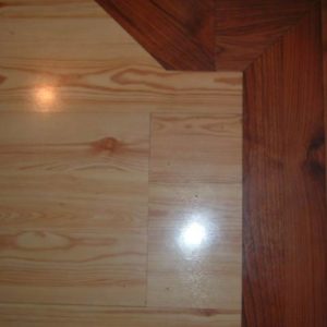

  3. Huntdoctor | Oct 11, 2009 05:51am | #9
    I will attempt to add pictures of the floor.
    Edited 10/10/2009 10:52 pm ET by Huntdoctor
    1. joeh | Oct 11, 2009 09:09am | #10
      It looks a hell of a lot better than I expected.
      Guess I was picturing roofing nails or the like when you said he'd nailed it.
      You'll have to mess with it some to get those pieces lined up where it's going around that island.  You're going to need some scrap to sacrifice til you get that right.
      Looks like he didn't stagger the joints, suppose you know to spread the joints like shingles so they don't go across the floor in a line.
      Joe H
