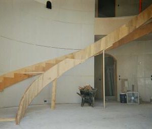

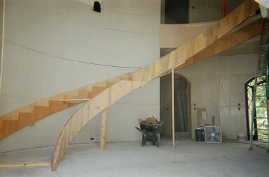

in the round, thirteen feet of rise and combined run of 58 feet, will be quartersawn white oak when finished

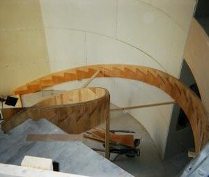

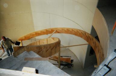

the stringers are going to remain closed, they will be plastered on the outside, the treads will be glued up tapered pieces of quarter- sawn white oak, and the risers will be plywood , laminated with handhammered copper tiles.

This stairs is in a cylinder that is about 30 feet in diameter, it goes up to about 32 feet to the peak of the dome that we built, and finished with 6"x12" hand hammered copper tiles in a herring bone pattern. The dome is a knock out, but it is too big for me to photograph with my limited ability. We did a lot of the other trick work on this project, but far from all of it. The house is around 10,000 feet of living area, on an awesome lot , located on saledo creek, about an hour from Austin.

here are a couple other pics, one of thje dome and an outside pic

What's the steel? Looks like pocket door studs from here LOL. Is there any bounce. I'm dying to do an open set.
And, are the risers faced with tile or wood?...& is that vertical trim piece at end of the riser mitered into the tread?
Man, I love your work, keep those pictures coming...maybe they'll help keep me distracted from this next term<G> Don't worry, we can fix that later!
BB,
The stair stringers are 12 pieces of 3/8 wacky wood, 18" deep on the plumb line, there is about 10 gallons of tite bond that was used to laminate them together, there is no give, bounce or deflection that can be neasured. The risers are hand hammered copper tiles laminated to 3/4" plywood, the treades are quartersawn white oak, and the studs that furr the bottom of the stairs are 25 gauge metal. Two reasons for the metal studs, they add no significant weight to the stairs, and they help facilitate the plane swap from side to side.

as per the metal studs on the bottom of the stairs, you know how the planes swap from side to side, the metal studs do the same, so the transition is eased from one striger to the other.
