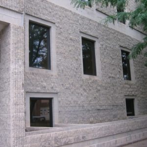

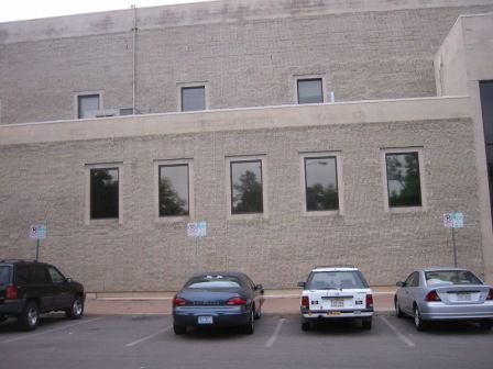

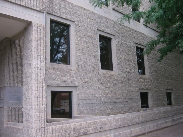

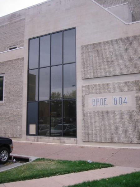

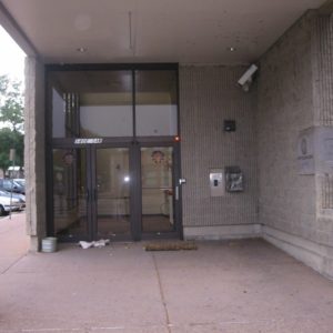

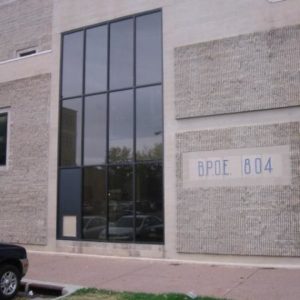

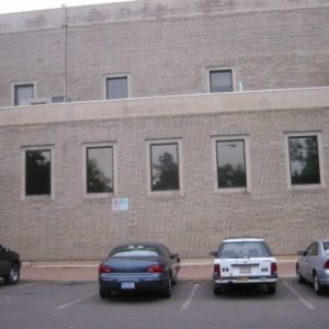

Hello,
I’ve been asked to bid the deconstruction of the storefront glass in this building that is due to be deconstructed.  One of the bid requirements is to find the best use for all of the glass and frames.
Ideally,  the successful bidder will find a potential buyer for the glass and frames, who will be able to reuse it on their own project.
Failing that, the aluminum is easily recycled, but what environmentally responsible options are there for the recycling of the glass?
Thanks for all input.
