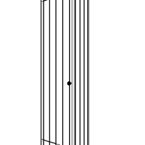

A rendering of a floor-to-ceiling linen cab I’ll build and install in a bathroom next week is attached.  Finish is 1×6 v-groove T&G pine, which we will paint white to match trim.

    Oops.  Sent the wrong file.  Open this instead.

      How tall is it???

        Eight feet.  Floor to ceiling.  The footprint is 28" wide by 18" deep.

          If it's floor to ceiling how will you stand it up. Loose toe kick can work but pic doesn't show one.Smile. It could be worse. You could be me working for you.

            It only has two exposed sides, being built into a corner.  The shelf cleats inside are fastened to the walls at the left side and across the back.  Cleats at the ceiling are fastened through, and the base is gorilla-glued to the tile floor.
