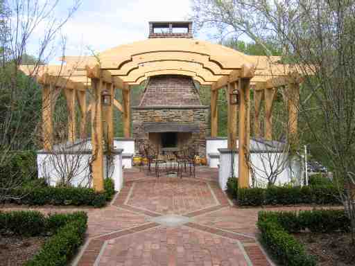

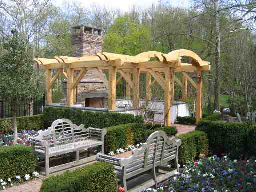

Hello gang,
Thought I’d share a few pics of a really nice Timber Frame trellis we built last Spring.
The wood is Port Orford Cedar. Pegs are all Ipe. Photos are a little small for ease of view.

Beautiful! Makes me want to stop and smell the flowers. So, I can't tell from the pics, are those arched pieces glu-lam, or cut from bigger pieces?
we cut the arches from 8x22's about 12' long.
Yep, 8 x 22's
Given the arch carries no weight, we thought the timbers would be OK.

You do nice work. Who did the design? Why ipe pegs? How long did it take to build?
Don
Design was done by a friend/Architect who I respect---it was his client. He has a good sense of scale and I work with him quite a bit.As for time, we built it in the shop, I belive it was about 300 man hours to make it, and about 3 days to put it up.
Very fussy install. It was all sanded with a 120gt RO sander, then 2 coats of Land Ark wood oil.

You guys use a portable (hand held) band saw for your detail work?
Thing of beauty.what did you cut the 8x radius with?

Thanks guys, We used a Mafell portable band saw for the curves....had a lot of trouble at first, then with the new $65 nut that properly tensions the blade...very nice. Joinery was all mortise & tenon, Ipe pegs were really for color...they are a nice dark brown. I'll get a few pics together, they need to be adjusted for size.

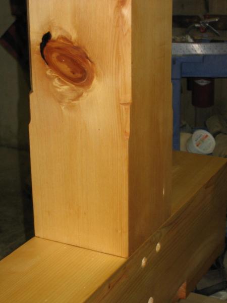

Here is a close up of a little hand cut Lamb's tongue we did on the posts. As well, a shop pre-assembly pic."there are 600 ways to loose money in this business...I don't know them all yet, but I'm trying"

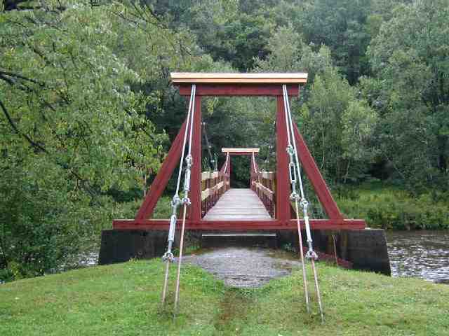

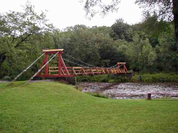

So why do the same thing twice? Here is another cool job we did....while the bridge was hanging.We replaced the 2 towers...Very FUN!!
Man, that looks like a super fun one to do, properly set-up' you know. How about more details. I could get into this timber stuff!
Got a closer pic of the bridge?I get paid to do carpentry. That makes me a professional.
If I work on my own house does that make me a DIY?
The bridge was 120' long and we figure weighed about 4THold your wallet, there are lots of ways to loose money in this game. Here is another pick for ya...one of my favorites.Take Care....BTW, my adopted home town is Milw. Home of the beer and the brave!

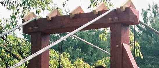

Can you explain or show us how the wood structure attaches on to those cabels ?
Well, they don't.The cables are resting in a stainless steel saddle. There are 4 cables on the bridge (that's how we were able to repair while hanging) 2 on each side. They are 7/8 overlaid bridge ropes--this refers to the way the wire is wrapped---so I had a SS saddle made by a friend. The top plate of the timber station is an 8x10 laid flat with a slot for the saddle on location. The saddle is held to the wood with a 1" pin. Gravity keeps it all glued. So the Engineer tells me, the weight of the bridge keeps the cable in place and balance keeps the tower plumb. Cool thing about this bridge is it wiggles when you walk it...regrettably, bureaucrats and codes would probably not allow something like this for the public. This is at a private outdoors club.
No, I meant where the vertical cabels come off of the draped cabels, how do the vertical cabels attach to the bridge deck ?
Well, duh. Sorry.They have a cable clamp that holds a "ring eye down rod" with a nut on the bottom. Deck is a 4x4 beam, then joists from beam to beam. About 8' from beam to beam. Hope that helps.
