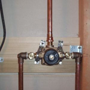

        1. ry91 | Jul 25, 2006 03:56am | #8
          Here's a photo. Didn't have time to add an arrow to show where it is leaking, but it's at the top of the rough-in, where the output for the showerhead line goes.

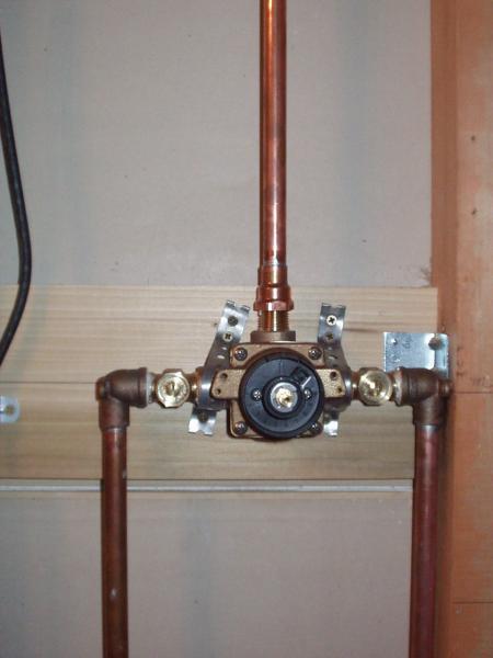

        2. ry91 | Jul 25, 2006 04:07am | #9
          Sorry, this one is rotated correctly. It's the top treaded joint.
          Thanks!!! Ryan
          1. BoJangles | Jul 25, 2006 04:50am | #10
            Those shower valve assemblies used to have female threads in them and people would overtighten the male pipe connections and crack the housing on the shower valve.  Now most of the bodies have male threads with the option of soldering the copper into the inside of the male fitting.  I would solder it and be done with the problem.  Just be careful not to apply any more heat than is necessary.  I have never had a problem soldering to those valves.
          2. plumbbill | Jul 25, 2006 05:25am | #11
            That joint looks awfully dry
            Put teflon tape on male threads then pipe dope over male threads then screw together.
            By chance you didn't solder that female adapter after you screwed it on to the Grohe did ya?
          3. ry91 | Jul 25, 2006 08:45am | #12
            The joint is dry only because I took the picture just to show the joint I was referring to, not the way it was as I tried to connect it when the leak happened.
            I did try the tape plus paste and that held pressured water for 4 hours. Is that long enough of a test? Won't be under pressure while in use.
            I'd solder the joint if recommended, but nervous about soldering the rough-in. Would I take out the assembly or leave it in? Should I use a rag soaked in ice water to keep the housing cool? Other advise? Just don't think I'm fast enough yet to prevent overheating, but with good info I can do. Would you still recommend soldering? Would appreciate the info even if you think soldering is unnecessary, for future reference.
