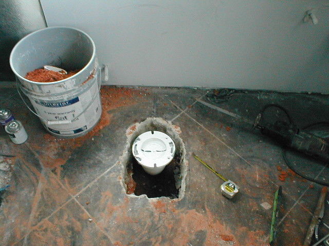

here what happen if you go 15 inches from wall

OUCH!
Headstrong, I'll take on anyone!
let say, ouch twice, I did both bathrooms the same.
