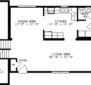

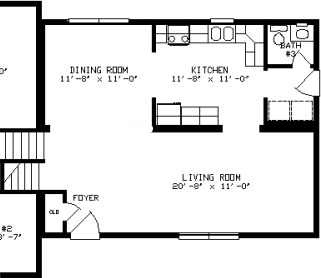

Planning to re-do/update and move to my parents home that was built in early 70s. I’d call it a tri-level. The ground level is kitchen, living room and dining room with a crawl space under it. 6-7 steps up to 3 bedrooms and a bathroom. 6-7 steps down to a basement that is half below grade, half above grade and under the bedroom section. Living room and dining room form an “L” pretty much like the drawing here. We’d like to open up the whole level, meaning remove the load bearing wall between the kitchen and living room.
My experience is in remodeling and small building. While I feel qualified to do the work, I don’t feel I can do it without a proper plan. What type of things do I need to consider? For example, is the steel support beam and columns in the crawl adequate? What do I want in a professional (engineer? architect?) who can provide me with a structural plan that I can follow. I plan to meet with the village building inspector in a few weeks to see what they require. I have the original blueprints. What would you expect a “plan” to cost me?

First step is to verify that the walls you want to remove are actually holding something up.
The concern when removing a wall is what is over it, not what is under it.
I would guess that there may be full-span trusses over this part of the house, and if so, you may be fine just pulling the walls out.
what is over this level?
"what is over this level?" --- Just the attic. Not truss construction. The wall supports the ceiling joists.
