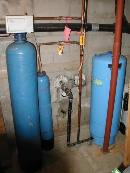

I'm getting close. I think it's an Amtrol Provectr System though I don't know the size or capacity. I have an email into Amtrol to see if there's a service book I can get access to. The website doesn't make it seem like the system needs servicing but I think my pH test earlier today showed that the water is certainly acidic.
Here's a pic and if anyone has anything to add I'll certainly appreciate it.

Supposedly there's an air injector on the system (feeding into the small tank) that could malfunction. Also, though they make it sound like the filter media is permanent, it probably needs replacing at intervals.

You have an acid neutralizer. Since the tank has no fill hole the only way to recharge it is to remove the timer head. If done improperly you will spew particles into the system that will clog every fixture in the house. I'd suggest get a plumber to do it. Watch him carefully and decide for yourself if you really want to try it.
PS... switching your pipes to cpvc will not solve your problems. Fixtures are made of brass and many contain lead which will leach out in acid conditions.
