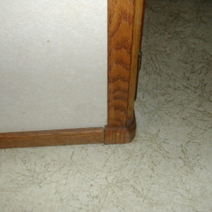

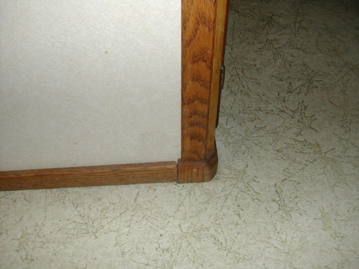

          2. junkhound | Dec 15, 2015 12:42am | #11
            Different take, have not coped -or mitered- a baseboard or chair rail or crown moulding for over 35 years.
            Decided the style most functional is a block in the inside corners, and a block on outside corners.  On radiused outside corners this is especially good as you can drill a 1" hole in a block and then cut a 90 deg notch out to fit the outside corner.
            Now all you need to do the corners is the chop saw with good blade.
            There are some areas I simply run a wood strip up an entire inside or outside corner, then dont need to try to finish the DWall inside corner that well either.  However, not very cost effective if you are building for somebody else or a spec house.
            MarkH | Dec 22, 2015 05:21am | #28
            I'm going to use my electric die grinder with a wood burr if I ever cope baseboard again.  Outside corners might be better with a block for impact damage control.  I think they look better too.
