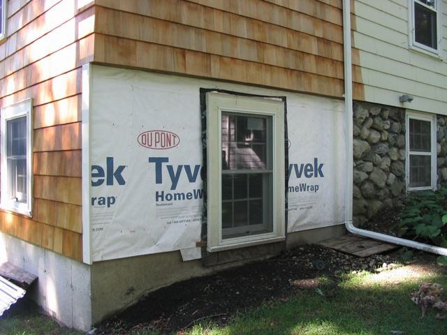

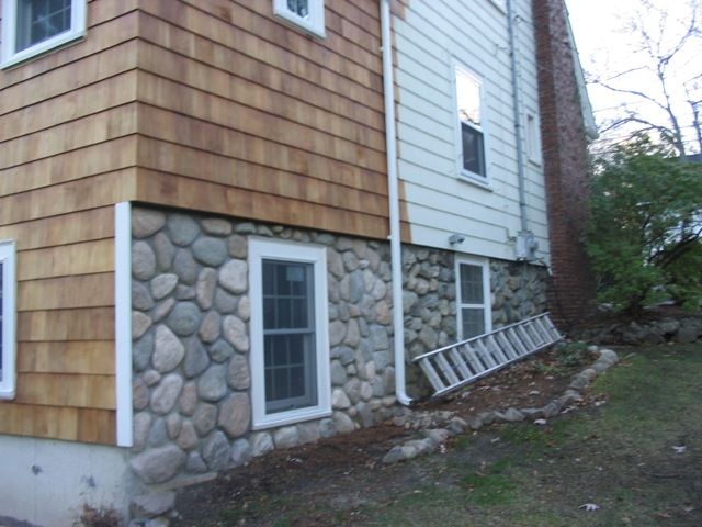

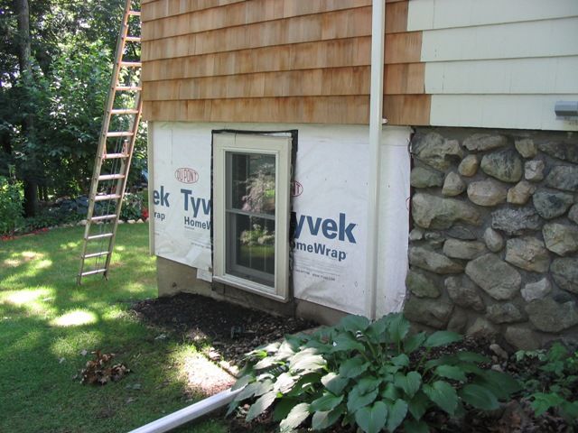

Justin,I built a shop in my backyard and decided to get creative with the entrance. I had never done anything other than a little tile work, but the learning curve wasn't too bad. Took me a loooong weekend. One day for the scratch coat and one to install the stone. I like the ledgestone as no grout is required. Pay no attention to that finger in the corner of the photo.

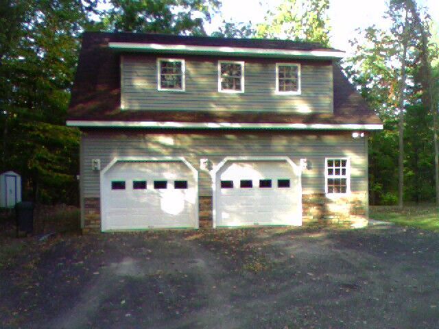

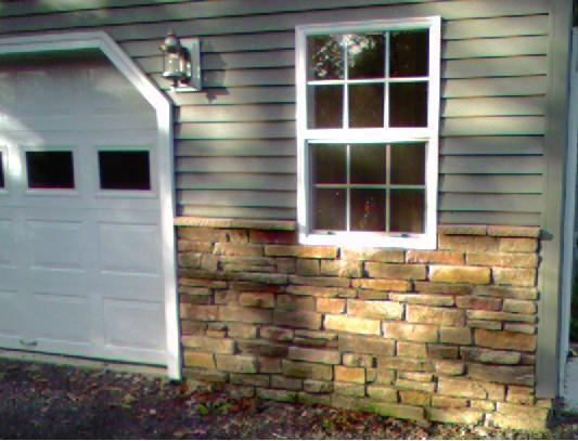

Pic quality isnt the best. But here is an external application.
2x6 - osb - house wrap - diamond mesh
Scratch coat applied over mesh, stone applied top down to avoid dripping mortor
1/2" grout joints
mesh + scratch coat 2 - 3 hours
layout of stone 5 - 6 hours
application of stone 5 - 6 hours
grouting 1 - 2 hours

Matt, these are some pictures of a house I just finished. All the stonework is real but all the trim is Azek. We used a copper coping or water table to transition to the stone. The tapered columns are hollow with a 4x4 or 4x6 LVL post inside.
Edited 10/1/2006 1:52 pm ET by woodguy99
That's a great looking house woodguy.Tom
Douglasville, GA

Not an expert by any means but I had a go at this after we had and addition put on. We have a fieldstone foundation and given the way we built the extension we didn't think anything else would look right other than facing it with some type of stone. Wasn't sure I could do it with real stone at the time. Figured I'd have to build some type of supportive shelf or take the stone all the way to the footing (which was about 8 feet down on that side, $$$) so I figured I'd have a go with the cultured stuff.
I had some issues finding out what should be used for an underlayment based on the surface I was putting it on (so your article would be great for someone like me) plywood in my case. Still not sure I've got it right. If I remember correctly I left the Tyvek, then some builders felt (30 lb I think), wire mess, then the stone. I also had issues trying to get a mix of mortar (colorwise) that would match the old existing mortar (don't know enough about how the different cement types dry). I tried a number of variations (Type I, Type II, Mortar mix) along with some colorings (never did get it just right). Consequently it has a few mortar colors and I'd like to go back with a thin coat to cover everything but it hasn't been high enough on the priority list. I'll take a few more pictures but I really don't like showing the parts that came out so so ;-)
I also wasn't sure how the cultured stone would hold up to freezing and thawing at grade so to be safe I used real stone for the lowest row. Had to put it up a bit at a time and like I said I'm not expert at getting mortar consistency correct (never did get it so I could squeeze it out of the bag).
So far so good, everything is holding fine. I was only able to find one picture so far and it's a bit blurry but I was pretty happy with the result. Wife was so happy she wants me to turn the corner and do the back section of the foundation as well. Can't say I disagree it was all just a bit time consuming.
that looks pretty impressive Ribs, nice work!Justin Fink - FHB Editorial
