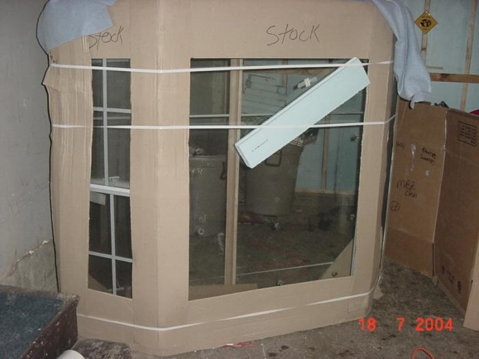

I have a new bay window that I got at auction. It came packaged to travel as you can see from the pictures. It has 3/4 in ply top, bottom and sides. and the corners have gussets to keep it square. the questions……
1. After I frame up the opening for the window and place the window into it. Do I use the ply bottom to support the window? or is it just there to keep the window square and I should plan on building another deck to set it on.
2. Same with the top. can I attach my roof framing directly to it or build it up more.
3. The side pieces measure 5 1/2″ wide. I assume for 2×6 walls…I have 2×4 walls. Should I cut it down? or Bring into the room and trim with imagination?

Yes you can frame the roof right on the upper flat. Yes you can set the bottom on the sill plate and add whatever ya want under it. and yes it's for a 2x6 wall, install and scribe it to yer wall finish and trim as normal.

You may want to visit a manufacturers site such as Anderson to look at the details for their recommended installation. Most bay windows are supported by cables that run through the corners and are fastened to the wall and header above. You can set the window on the bottom but you may want to provide some way of insulating it both above in the rafters and below. We often box out the bottom. The top may be attached to but be careful not to pound a 16d through that head board. If matching some existing trim detail or if the build up (down) for soffits and fascia will encroach on the window itself you need to build up. Read the thread on trimming jambs flush,38462.1. Does not look like you have any room to be trimming inside that unit.
In the event the window did not have cable supports at the top, you can do knee braces or corbels to support from below.

I was planing on suporting from below. Not much room to the roof. this window will be smaller then the one that I'm taking out. about 2 inches narrower and 3 inches shorter. not looking forward to trying to trim out the outside to fill in the gaps from the vinyl siding. But old window is shot! so she's coming out
