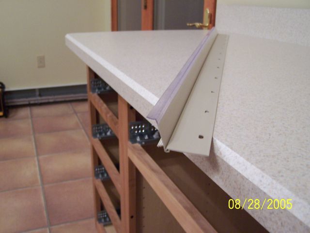

2--the top(head) nail flange incorporates a drip edge that extends over the window frame. Is this sufficient or do I need to fab one from trim coil? I can't see what another drip cap would do that this one doesn't.
I attached a pic of the flange/drip cap in question
There was another thread about window flashing in the past week. Check out the June article in the Journal of Light Construction on flashing windows, the technique they demonstrate is quite good. FlexWrap is a great product and worth the money IMO. You can also do quite well with a soldered copper pan, but it can be hard to get unless you have a good sheet metal connection.
Edit: the issue with what you describe above is that you did not get the top flange UNDER the Tyvek, if I read it correctly. That's what you should do. The JLC technique is to then apply the Vycor to the sheathing above the window, under the Tyvek and over the fin. Then let the Tyvek sit over the Vycor and the fin also.
You are now depending on the seal between the Vycor and the Tyvek to protect your window. It will probably work OK.

I bet that is a Marvin window!!!! They use the same drip cap. If you do not use it and ther is a problem... Maravin/ distributor will walk away and claim you did not follow correct installation proceedures.
you should use wrap over it after window is installed before siding or brick goes on.
Yep...Marvin Integrity series. An excellent product IMO and the Co stands behind their products too. Trust me on that one LOL. Just ask Imerc how analistical I can be<VBG>
I have no intention of omitting their drip cap/flange. I just got the impression from some research that I should use an additional one. Guess not..............:)
